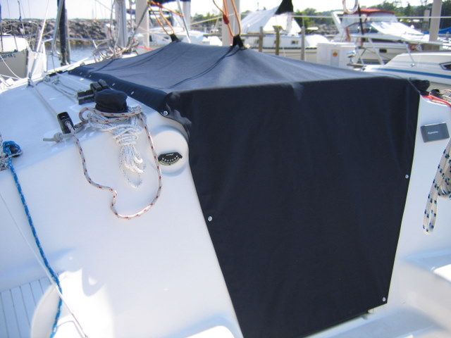

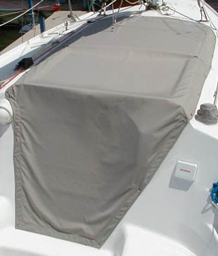

Bob, my H26 which is very similar to your H260 also leaks at the hatch. I understand this is common for the whole line these Hunters. The previous owner of my boat made a cover out of Sunbrella that covers the whole upper sliding hatch and vertical companionway hatch covers. It is held in place with about 10 snaps. BrianW

I agree with Brian, the Sunbrella cover fixes the problem for good. However, there is a wood stopper at the back of the hatch that can come loose and allow water to drip into the cabin. Re-attach the wood piece and the boat will be very dry except when heavy/blowing rain is too much for the drain.
I purchased the cover from the chandlery and had a sailmaker add a couple of loops to keep the water from pooling on the hatch. Got this idea from Jim Seamans.

Additional Benefit of Sunbrella Hatch Cover....
When installed, my Sunbrella hatch cover also allows me to keep the hatch open in a light rain while underway or on the hook, without the rain getting inside the cabin. All I have to do is extend out the part of the cover that covered the hatch boards to the horizontal position, bungee it to the bimini and it forms a companionway awning. This keeps the cabin cooler in stinking hot weather. BrianW

I'm sold I'm going to order one this week......

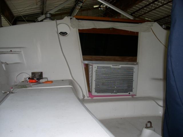

$20 worth of sunbrella, a couple hrs on a sewing machine and a few snaps will permanently cure your hatch leak. Then set a small a/c unit in the companionway and let it run a few days to dry out the interior nicely. After especially wet cruises or long periods of high humidity(which Fl certainly has) my little $85 home depot a/c pays for itself in spades.

I used caulking on the two pieces of wood on the sliding hatch. I still have the old tent fly over the boom. It has completely stopped the water leaks ! I went ahead and ordered the Sunbrella hatch cover and a boom tent from Hunterowners.com. I was missing a galley port screen, so included one of those, and I also ordered a pair of their stern seat covers.
