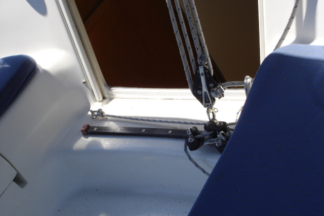

I have recently bought a 260 with two jibs, one standard issue and the other about a 150.
The sheeting blocks are mounted outboard and just aft of the cup holders on a short track.
I race this boat and am still finding out the best sheeting positions. Judging by the tell-tales and the leach it is obvious that the jib-sheets need barber-hauling and I am thinking of fitting them via a block on the Gunnels anchored in a similar way to the shrouds. and controlled from the cockpit. Out of eleven boats, there are three Hunters two 260's and a 26. Its early in our series as yet but out of four races I have won three and third in the fouth race (with a six minute handicap). As for only half a knot, that is all it takes providing it is in the right direction. I believe there is more to come from this rig but Am not sure how it will behave in a blow. Just thought you may be interested

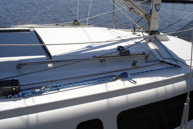

I sailed in the North Channel of Lake Huron this past summer, there was a Hunter there with jib tracks and a small traveller, it appeared to improve the performance of the boat. The boat name is Incipient. A couple of pictures below.
Jim Kelly on this forum has a 270 that has a 150% genoa on it that has the sheets running back to the cockpit coaming to a block mounted just at the pushpit. The block is mounted on a swivel with cam cleat. The boat sails very well with this sail, it is a tiller boat and seems to balance well. This boat also has the small traveller mounted on the companionway step.
