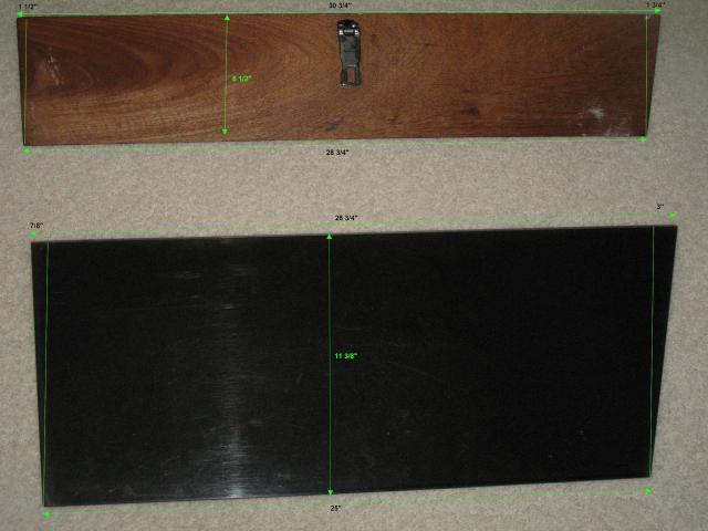

This last weekend I took the boat out when I brought it back I snapped pictures of the boards and took measurements. This is the first picture of the two lower boards. I'll get the others done in the next couple days.
George, I don't know if the h260 website has these dimensions but you're welcome to copy them.
The dimensions for the lower board are: 25" bottom width, 28 3/4" top width, 11 3/8" center height. Left side top "offset" 1 1/2" (about 7.5 degrees), right side top offset 3" (about 15 degrees).
The dimensions for the upper board are: 28 3/4" bottom width, 30 3/4" top width, 6 1/2" center height. Left side top "offset" 7/8" (about 7.5 degrees), right side top offset 1 3/4" (about 15 degrees).

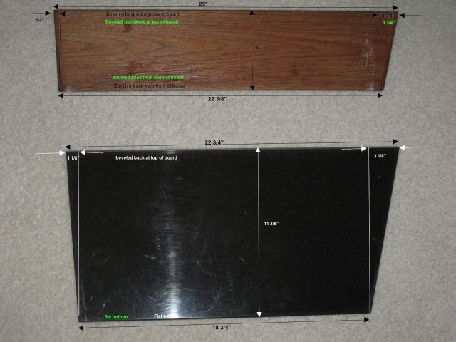

Here are the other two hatchboard dimensions (the top two boards).
The dimensions for the lower board are: 18 3/4" bottom width, 22 3/4" top width, 11 3/8" center height. Left side top "offset" 1 1/8" (about 7 degrees), right side top offset 3 1/8" (about 15 degrees).
The dimensions for the upper board are: 22 3/4" bottom width, 25" top width, 6 3/8" center height. Left side top "offset" 5/8" (about 7 degrees), right side top offset 1 3/4" (about 15 degrees).
I know, the heights of the plexiglass pieces should be the same, and so should the offsets; and the heights of the wood boards should be the same and so should the offsets. Mine aren't for some reason.

Any call on the angle to the top and bottom cuts? Are those measurements "long-to-long"?
MikeH
Jan 7, 2004
157
Hunter 260 Perrysburg, OH
Help me understand your question Dave. Do you mean the vertical angles on the sides of the boards, or do you mean the front to back bevel angles between the boards?
Yes, the measurements are long-to-long because I figured people would cut the boards with a perpendicular saw, then bevel the tops and bottoms to fit.
I've done the calculations and edited my previous posts to include the angles.
