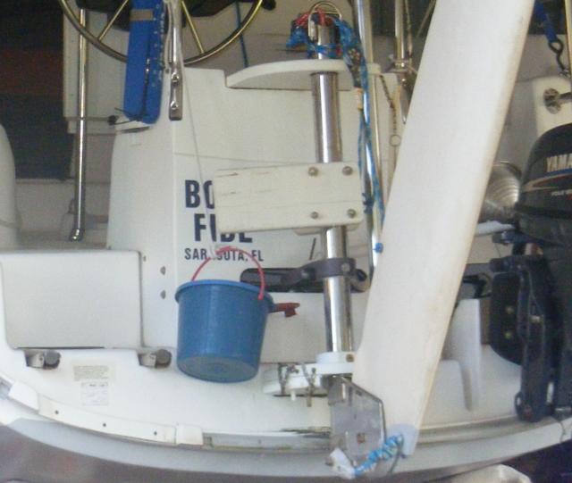

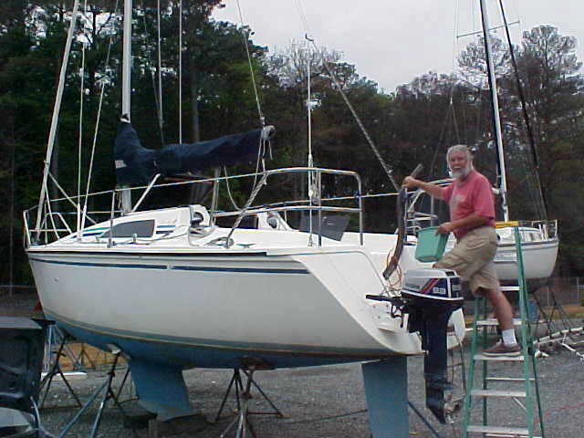

I am also looking for a good way to mount a small outboard motor on the back of the boat. I have seen pictures of a bracket behind the helm seat so the motor is hanging out behind the helm, but not enough detail in the shot, it was a boat that was for sale. I include the picture below, maybe someone has seen this boat and can add some details, it has a full dodger/cockpit enclosure as well. If you come up with an elegant solution please post a picture. I am heading south with the boat in January and would like to solve this before I leave.
My Hunter 26.5 has a factory mount. Here is the best pic I have of it.

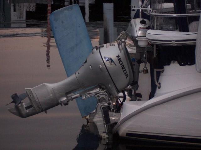

I built a small motor mount for my 2hp dinghy motor that fit onto the upright rudder tube. Mounted there it kept the weight low and could be slid down and serve as a backup outboard for the big boat if my 8hp died for some reason and it was still out of the way as a storage placement. Here's a pic. 4 stainless bolts w/nyloc nuts bolted through a short piece of 5" pt stock. I only bolt it in place on lengthy week long runs. Not sexy but works perfectly.

Great idea Mike, I will try to whip one of those up for my trip, thanks for the idea, Bob
