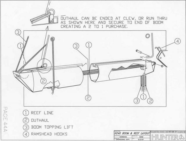

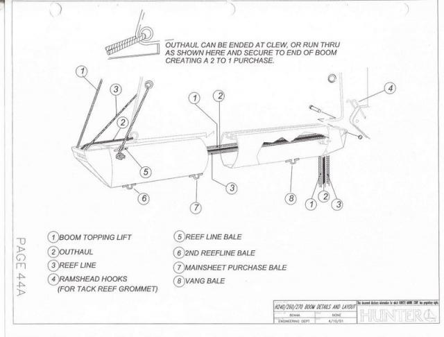

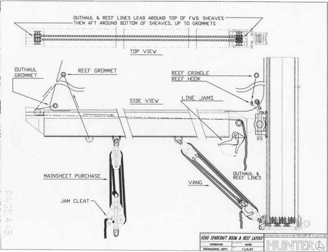

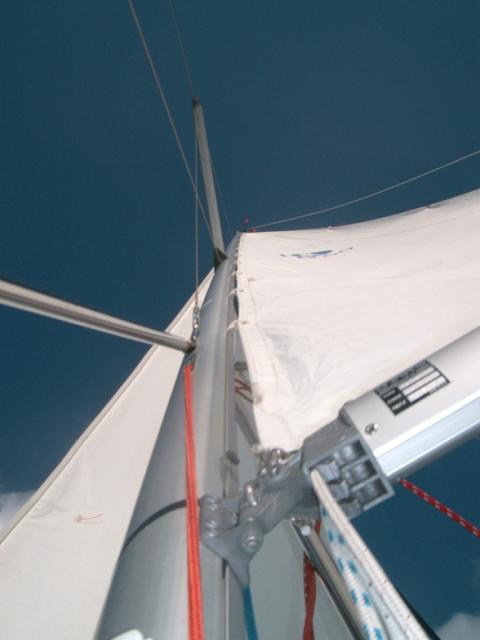

The bale of the shackle goes through the main tack cringle. The shackle pin goes through a hole in the top of the gooseneck.
As seen in Soling42's pictures above, on the end of the boom looking forward; the right hand line goes to the outhaul, the center to the reefing cringle on the roach, and the left hand line goes to the topping lift.
I found "Line Keepers" that I mounted to the mast, below and on ether side of the boom. These are inexpensive items that keep things neat.
