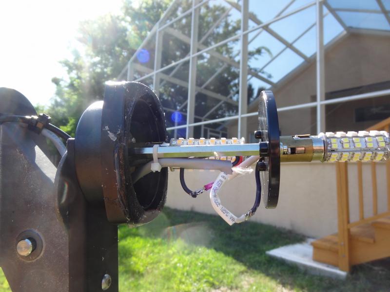

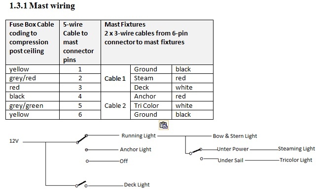

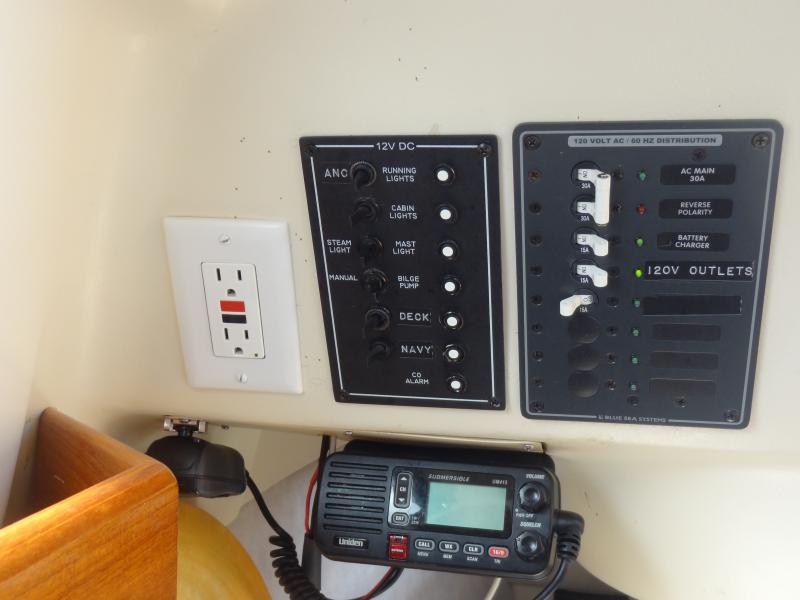

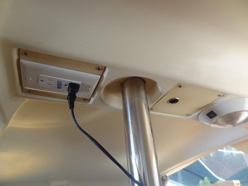

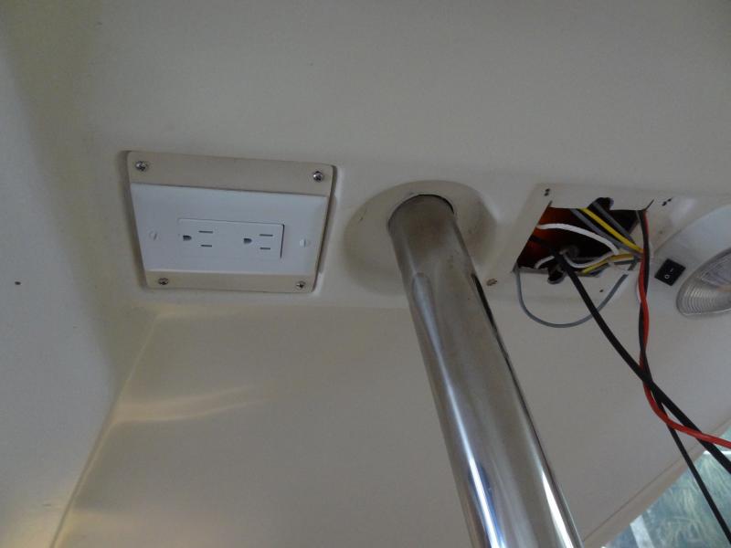

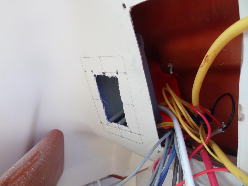

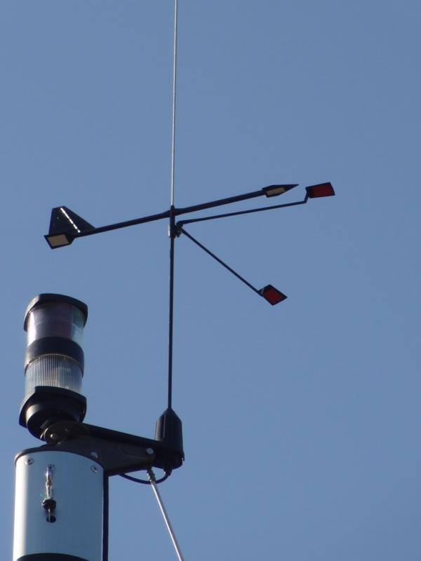

I'm re-wiring my H26's mast lights. The wires inside the mast are OK and will be left as is. The current wiring has four wires exiting the mast.... one each from the anchor, steaming and deck light...... plus the common ground wire. The deck light wiring is not connected to any power. My problem: I only have 3 wires leading from my switch panel and through the cabin overhead. .... including the ground. The only 2 "hot" wires run to a 3-way switch. Right position.... anchor AND steaming (via a jumper). Center position.... both off. Left position.... steaming light. This makes NO sense to me. My impulse is to remove the jumper, so that left position is steaming and right is anchor light. What do y'all think? My next problem: I have no switch or cabin overhead wiring for the mast-mounted deck light underneath the steaming light. Am I missing something? If needed, how do you fish wire through the cabin overhead. It's a very indirect tight path. I have no conduit. The existing wiring is stuck fast, so I can't even use it to pull a duplex (or more) wire through the cabin overhead. Any advice? While the deck light has never worked, I would really like to have it. I Thanks! BrianW
