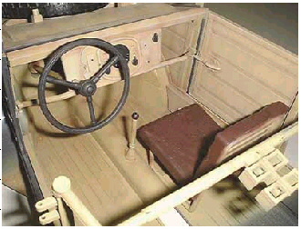

I couldn't find any pictures in the HOW archives and I don't have an H26 manual scanned. However, here is the mockup I built in my basement for our 1995 H26. There is only one real problem with this configuration. You need to be left handed. Although it overcomes the deck stiffness problem, it does take up a lot of cockpit space. Note: My wife was not happy with the need for a tire on the sliding hatch so we ultimately scrapped the project.

Special purpose device
It only LOOKS like a stick shift. Its actually a shot glass holder. I way over designed this thing. By the way, www.edsonmarine.com does show a small boat wheel steering system that might be usable on the H26. The decking problem seems to be a big risk though. I don't know if the current kit has the same design as the original kit but it might be worth investigating if you MUST HAVE WHEEL. Markdb
