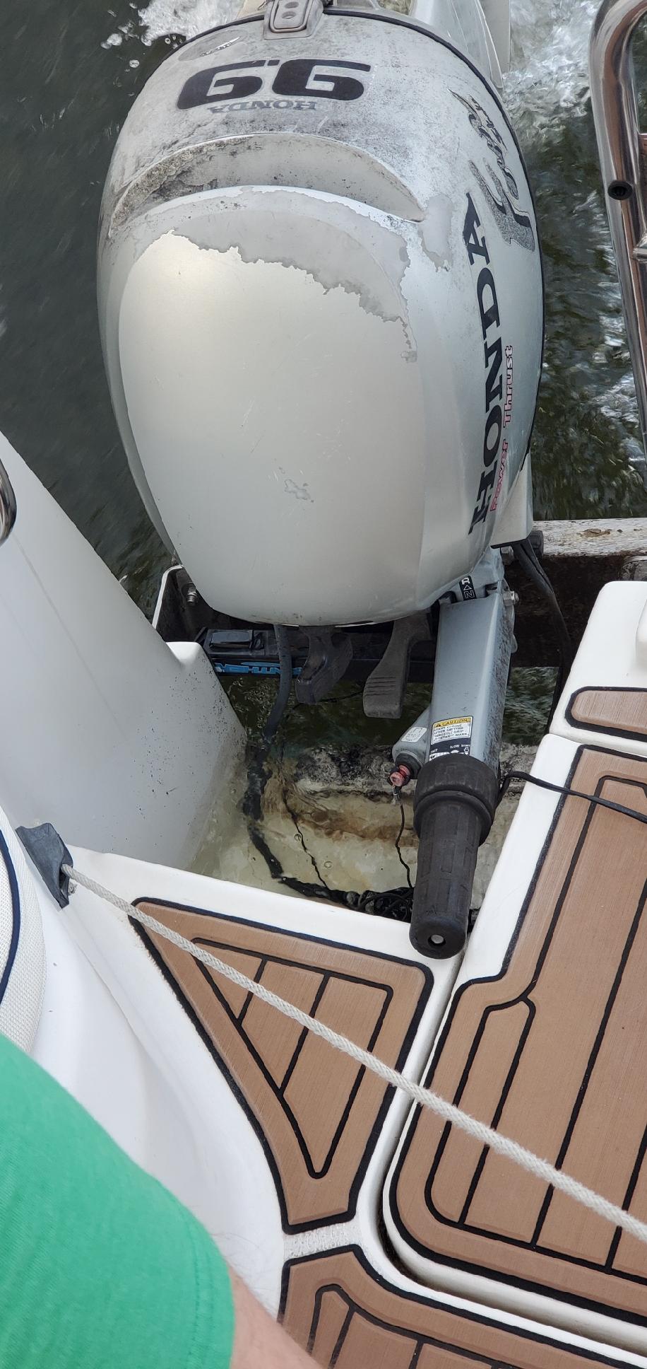

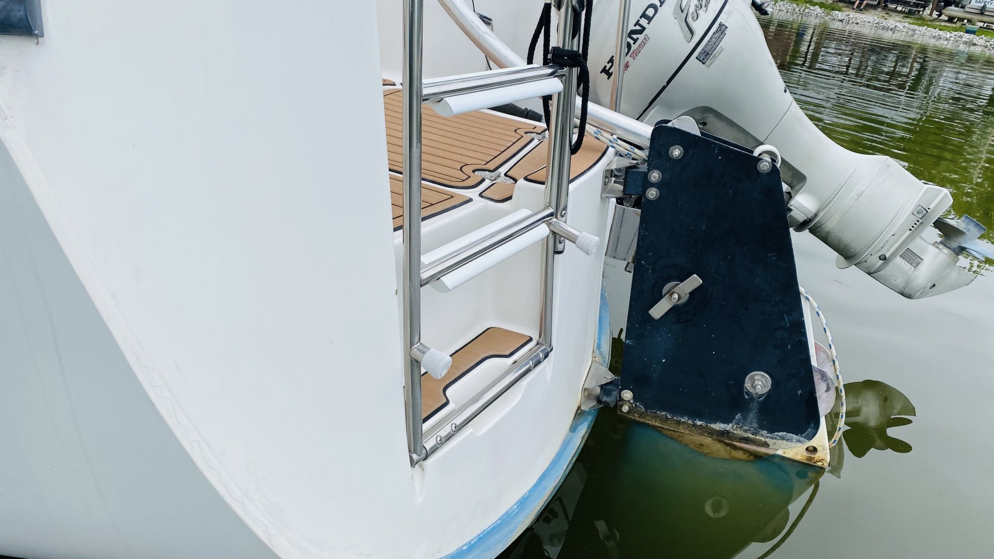

Here is a shot of a few inches of water in the gas locker area with the fuel line floating under water on a starboard tack with only 3 normal adults on the boat. Also a picture of the waterline docked with no one on it.

It looks fine as the water level with no one on board where the hull to deck joint meets on the transom appears to be above the water line. Probably overloaded on the boat with too many people. Call me next weekend as I am in meetings this coming week

JimSails, why is there a huge difference between the level of the water between the two pictures. The one showing the motor well is real low :yikes:. The other one that shows the transom looks normal. Sure seems like there must have been excessive weight at the stern, or there was a lot of water in the bilge.
the high water is specifically under sail on a pretty good tilt with starboard being the lowside. The boat is clean dry and mostly empty for day sailing. My question is if other people experience the same as it seems concerning, but the boat is in quite perfect shape. Do you experience the same? Thanks!

I’d say mine sits a little higher but is similar. Look down the side of the boat at the dock. The waterline stripe on mine is parallel to the water but above the water a good bit (with no people) We were surprised how much just adding two people made to height height in the water. The water we were in left a high water mark and when we got off the boat we could see how much us getting off changed the height in the water

I noticed your motor is dragging in the water even though it is up. Ours too and so we would sail with it down for less drag (ours wouldn’t stay vertical like yours. Anyway I was astonished how much water it would push still. The motor mount seems way too low. Some others have raised theirs. I’m planning to do the same.
