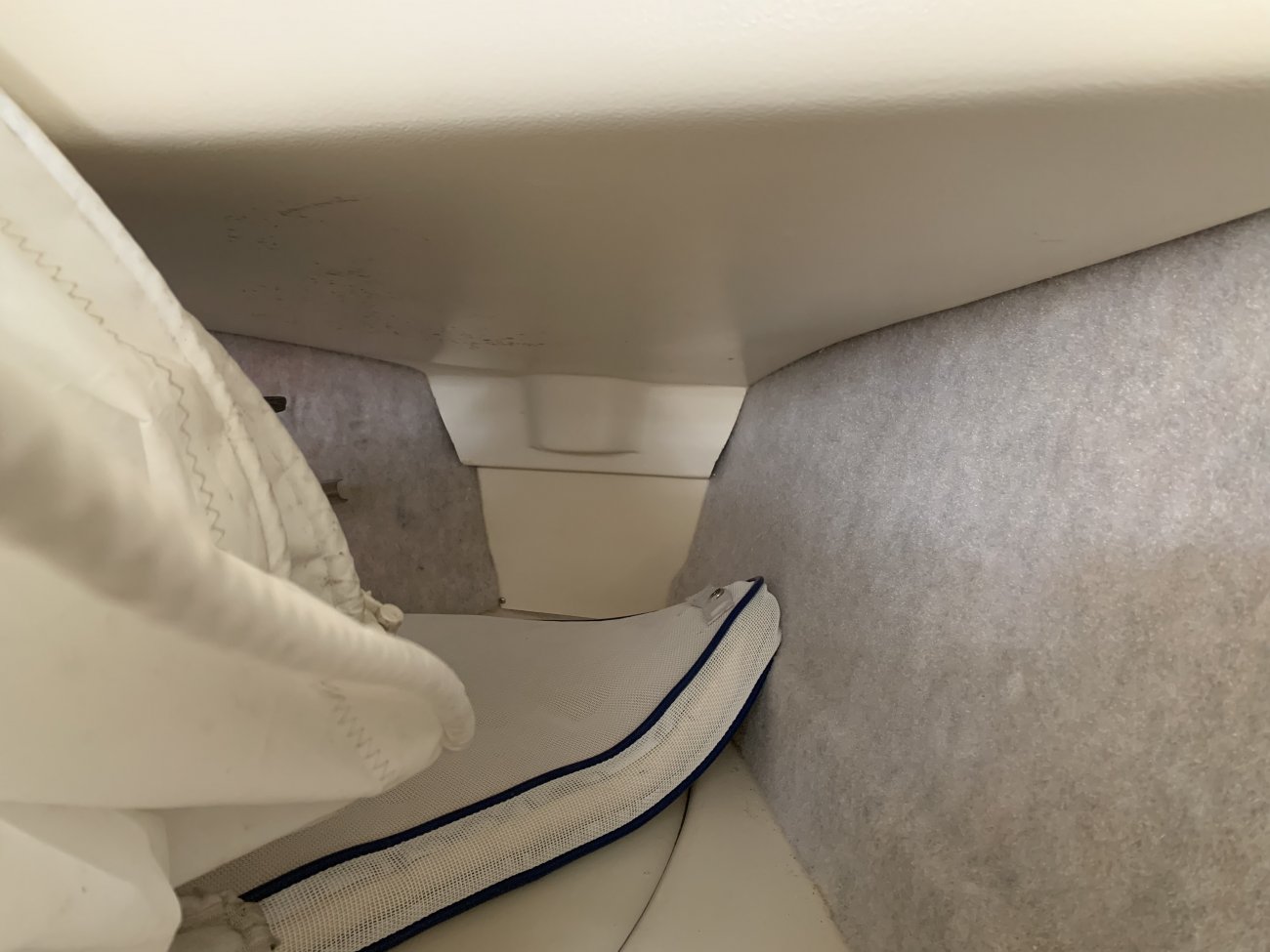

@twalker H260 the sealant is all over the metal plat at the bottom of the compression post onto the top of the tower. I can lift the wood cover and see underneath the floor around the post tower.
Thanks for all the replies.
If anyone knows how to replace the anchor locker thru hulls which seem to be behind/above the plastic ceiling let me know!

Not sure on the 26 but on the 260 I believe the anchor locker fittings are behind the small wood panel right at the bow of the vberth.
I’ll try to get you a photo in a bit.

@twalker H260 those are both excellent links thanks. I did not see any visible way to remove that "forward V Berth cover plate " as @Crazy Dave Condon mentioned, but will take another look.
We are using dock lines to the bow eye vs. bow cleats for our foreward dock lines so maybe that is ill advised as well.
12,721
Hatch access on the 260:
Assuming yours is similar there should be one screw in each of the lower corners - remove them slide bottom up and out. (One is just visible in lower left. Vberth mattress does need to be removed.
The 26 is the same.

My 1994 H26 had a fresh water tank in the compartment below the V-berth that leaked. When it leaked, it collected in the port compartment under the seat. I removed the tank because of the leak and the water always smelled dank. Also, I discovered a leak from my anchor locker. Debris in my anchor locked clogged up the drain. In a downpour, the anchor locker would fill and leaked through an access plate located higher up on the “wall” of the locker. The water ended up in the port seat compartment. Once I cleared the clogged anchor locker drain and removed my leaking water tank, the water problems were resolved.
While I was troubleshooting these leaks, I removed the wooden plate mentioned in a comment above to inspect the space behind it. From this access point, you can inspect the flexible hose connecting the anchor locker drain to the thru hull drain. You also can access the bow eye and bow cleat(s) backing plates and bolt/nuts and the bow navigation light wiring.

I had a leak in my anchor locker drain earlier this year. As the boat sat on the trailer, it had a slight up pitch. The water would collect in the anchor locker and leak at the thru hull. It would then gather in, what I later learned to be, the cockpit table holder recess in the bow there at the V-berth. It was even leaking so bad that it would overfill and run into the galley area.
I disassembled the thru hull and used Butyl tape around the thru hull on the locker side. Tightened it up and leak checked with a few buckets of water.
10,500
-na -NA Anywhere USA
When you take off that forward V Berth cover you will find it to be tight. Suggest trimming a little very little so it will not be so tight going back in
