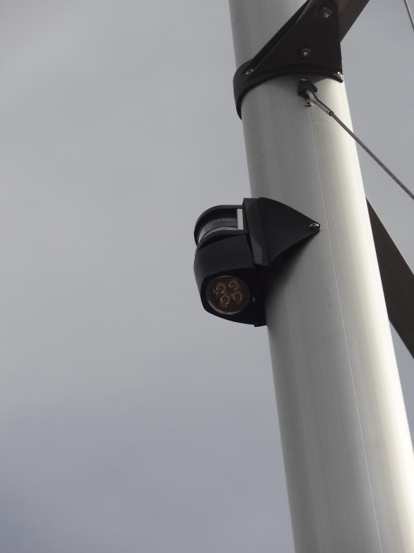

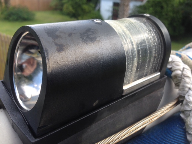

On the Aqua Signal steaming/downward pointed deck light, does the deck light have a clear lens? Mine obviously doesn't. Somehow I never noticed before. Thanks, BrianW

Brian, some did not have the lense and I think you have one of those. I could be wrong but suggest that you email the manufacturer with the photo and they are good to respond back. Look at West Marine for that specific deck light and see if there is a lense offered as a replacement. If not, then I think I would be correct but sometimes I am worng.

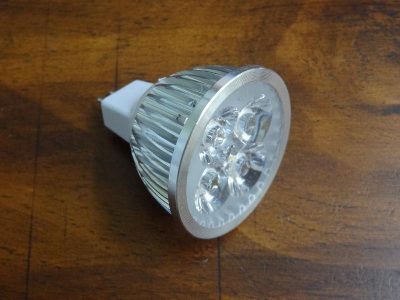

No lens here either. I put a LED lamp, all encapsulated, so no need for a lens.
Gives a very bright deck light and draws only 4 Watt on 12V (0.33A).
