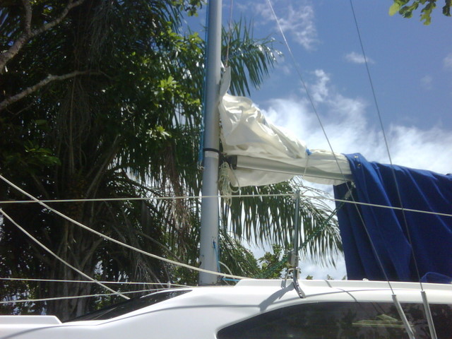

I've come to discover that the rigging as described and depicted in the H26 manual is "different" from what is actually on the boat! On closer inspection of the mast I discovered that it doesn't have topping line port mid way up the mast. The same deal for the forguy.
I bought all the lines as listed in the manual. On my H26 there are two lines that extend from the top of the forward facing side of the mast. These I've never used. One is deteriorating so I decided to replace both of them.
