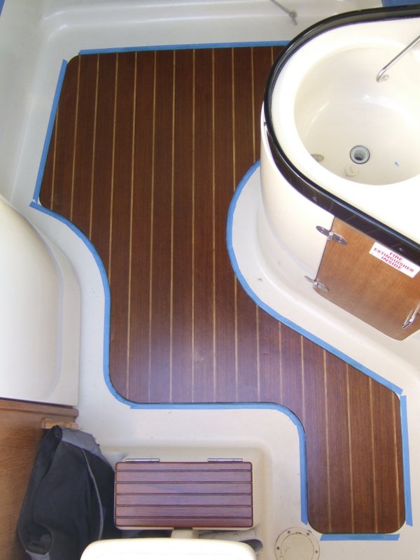

Happy Friday! I'm at the boat, crummy weather, so I've decided to tackle one of my 4 remaining projects: refinishing the sole.
I washed it with a teak cleaner, then gently hand sanded with fine grit paper last weekend. It cleaned up some, but there are still areas that show water staining and foot oils from its prior owners... I palm sanded with 150 grit, then opted for another round of teak cleaner. Some improvement, but still far from what I'd like to see. It's drying as I type.
My question is, how hard do I hit it with sanding vs. just accepting it's 20 years old and it isn't coming back?
The original varnish is like nails - it doesn't seem to come off with 150 grit paper and a palm sander. Do I go all kinds of crazy with, say, a 100 grit? If yes, for how long? I know the real veneers on these boats are only maybe 16th of an inch (at least on the table; take a guess how I know? #%*¥&@!!!)
Any help is appreciated. This boat is sweet, but she's taken some heat from the last guy who owned her. I'm doing my best to get her back, and largely succeeding. Just wondering where I go at this point on the sole...

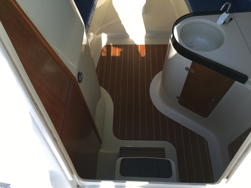

My 1994 H26 sole came out. It was laid in with silicone caulk (or else had been removed and installed by another owner). It had been varnished but was thin and not in good condition. I didn't want it to stay slippery, or hold water in and under it when I inevitably got some water in the cabin. So, I brought it home, stripped it, sanded with a hand orbital gently, cleaned, and then used some Penofin oil. I'm not a great woodworker, so others may say that's not the best, but worked for me and makes adding another thin oil coat easy later.

I used a palm sander and then a coat of sealer and two coats of hardwood floor finish. Pretty happy with the outcome.

Crazy Dave said previously that the way to refinish the sole is teak cleaner followed by light sanding. I used teak cleaner, sanded, then teak cleaner, then more sanding. Still had stains. I used a palm sander and 6 sheets of 150 grit paper (changed it when sanding efficiency started to taper off).
I did the best I could. Not real happy, but I guess it's better than it was. Sure made a mess of things, even with my shop vac running right next to the sander...
Mar 24, 2013
115
Hunter 26 MN
Tha thanks, Sam. I'm not thrilled with the results, but it's better than it was. The wood tones may even out a bit more as I add coats of varnish. The pic shows the floor after 2 coats, and I hope to add #4 tomorrow.
Yes, the H20 was easier, but the H26 is soooo much more boat. I just need to fight my natural tendency to expect perfection and live with the fact that you can enjoy the heck out of a great boat with an imperfect teak n holly sole. A few more years of therapy and maybe, just maybe, I'll get there haha!
It is what it is. She's a fine boat - my slip mates tell me they don't even recognize her, that it looks like a new boat. Yeah, they're trying to make me feel good about the effort I'm putting in, but I have to agree, she's the nicest 26 footer in our Marina, and that includes several H260's. I can take solace in that fact...
