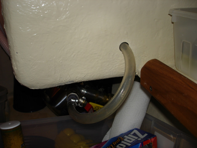

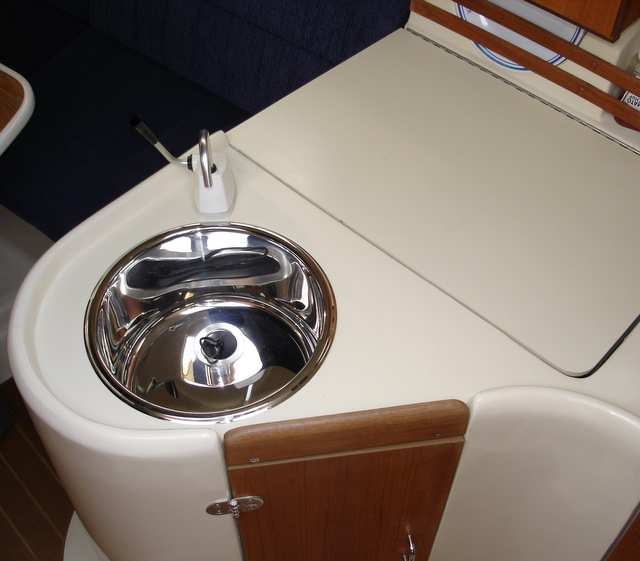

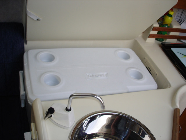

I really like your cooler solution. At this point I just moved up to a 5 day cooler, with the drain connected into the sink seacock hose. I have been looking at the Engal refrigerator/freezers but all of this type are so tall they would require major surgery to install there. I have considered installing one in the v-berth but would like to keep as much weight as I can off the bow as I am using 70 ft of 1/4" chain on my rode now and the boat is trimmed well so don't need any more weight up front.

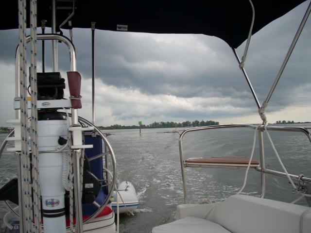

Whats up with the angle of the main sheet. My MS is relatively vertical and cramps the size of my cockpit table(which I rarely use anyway). My MS is attached on the boom just a bit forward of my bimini when it's in place. Maybe your bimini is simply bigger than mine.
I would have thought that your Edson pedestal came with a wheel brake or did I misunderstand your comment. I also ended up replacing our stock igloo cooler last summer with a 72qt igloo marine at west marine it's a major benefit although as you mentioned weight is adding up everywhere when I get "ingenious" with yet another perk. Lately it's all in the bow. The countertop lid had to go and the larger cooler's a very tight fit but when we're onboard overnight or longer the lifespan of the ice and extra storage space is great. Also added a simple drain so moving it isn't such a pain too.

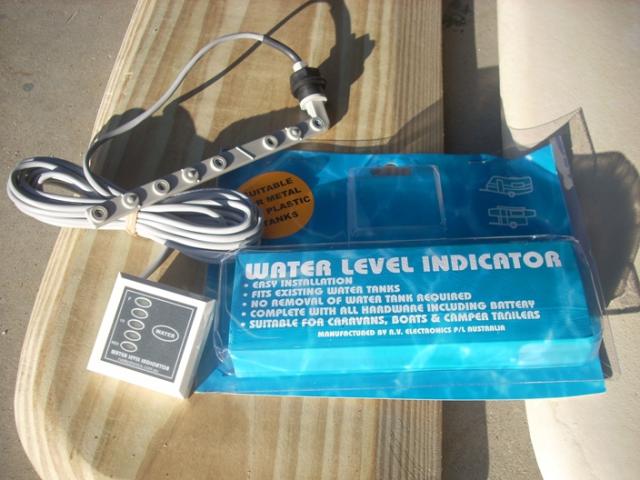

If anybody has any ideas about adding another 20 gals of water storage that'd be balanced within the boat and not too impossible of a project I'm all ears. Even when skimping having only 20gal with or without guests on a hot day it goes fast. A bladder secured behind the rear bulkhead is all I can imagine.

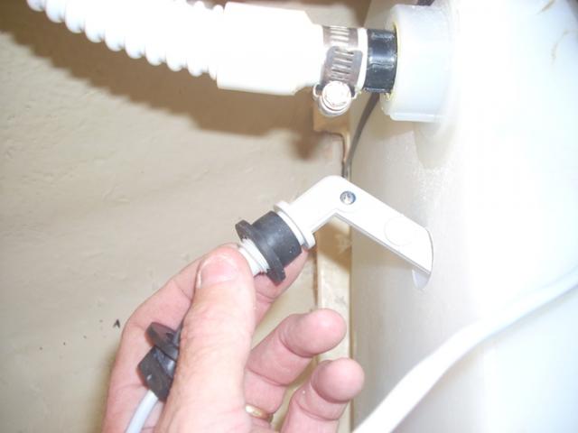

My water gauge mod is still working flawlessly and is a huge help. Easy to install and well worth knowing when we're getting low without unnecessarily wedging into the forward hold. Here's a pic

Mike, I didn't see a post about your water tank indicator, looks like a great idea, will have to put it on my list. Where did you buy it ?
As far as the mainsheet goes it was moved forward maybe 6" by the selling dealer to just clear the front of the bimini. It may be the angle the picture was taken perhaps ? It in fact just clears the cockpit table. If we are not using the boom tent we will often move the MS over to the side to just clear it out of the cockpit altogether. The only other pcture I have of the MS angle is when I tested the fit of the anchor sail, maybe this puts into perspective better ? The MS does press against the end of the table a bit so would not want it any more vertical than what it is. I have about a 12" wire between the end of the MS and the attachment point on the deck to make it easier to use the cleat, it gives me a better angle.
The wheel did not come with a wheel brake and without an autopilot and the jib sheets so far away it did not make sense they would supply the boat that way, so $200+ later we had a brake installed........
I like the 5 day cooler, not as much space as we would like but does work so much better that the Igloo supplied by Hunter, in hot weather it would have water running down the sides. I like to be able to close the lid and have use of the counter space, I drilled a hole to run a drain line out to a ball valve T'ed into the sink drain, makes draining the cooler so easy.

Water tank sender link http://www.rvelectronics.com.au/page.asp?parentid=3&parent2id=67
WG201 fit fine and was an easy install. I mounted the sender to cover the area mid way between the top and bottom of the tank and easily fished the small control wire back to the galley side wall. When the gauge reads it's lowest i still have a few gallons of reserve.
I noticed that your bimini is the same size as ours but mounted about 6" further fwd(see pic) on the rail giving you a tad more room at your table. Got to love the cockpit roominess for entertaining in these boats with the MS pulled over to the side rail which is a great setup.
Our slightly used '04 came rigged with the wheel guard, a brake and jib sheet spinlocks, lucky me because they're all extremely practical for this boat especially single handed. Of all my mods I'd say I use the AP the most because I'm often solo. Whether it's a long haul down the coast or simply to hold a heading while I winch a sheet or grab a cold one, it's been great. Unfortunately Simrad discontinued the WP32 which seems to be the best choice for the buck.
I opted for one relatively giant cooler instead of a small frig because of our longer coastal trips and having to otherwise need a 2nd cooler on the cabin floor under foot. It's wedged in but is a great icebox and the lid is the same height as the counter top and nearly as big. Sorry no pics.

Mike thanks for the details on the fresh water guage, I will look into that.

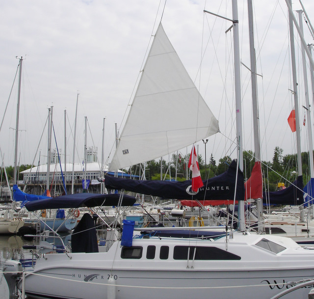

Your last pic shows what I assume is a riding sail set on the topping lift and sheeted forward somewhere. Got any details about that? I have noticed that the boat will "hunt" (hence the name?) while at anchor, and a riding sail can fix that.

Bilgewater, I made the sail out of an old jib off my previous boat because of what I thought was excessive sailing on the anchor. I have only had a chance to use it once so too soon to say how well it works. Mike advised me not to expect much from it.
I also switched to chain rode (70 ft of 1/4") and a bridle and found that helps a lot. I also have a 10 lb mushroom anchor I will sometimes use as a kellet on the anchor rode, right on the bottom directly below the bow roller.
Some sailors advise using a kellet or small anchor set off the stern at the extreme excursion of the boats swing.
The best solution is supposed to be anchoring your boat at the stern instead of the bow, then you have no swinging at all, but with a 260 the cockpit might get wet and it will be more difficult getting in and out of a dinghy in a blow. All details are explained here, http://www.jordanseriesdrogue.com/D_14.htm
If I ever get a good solution I'll post it on here until then I'm waiting to hear what others have tried.

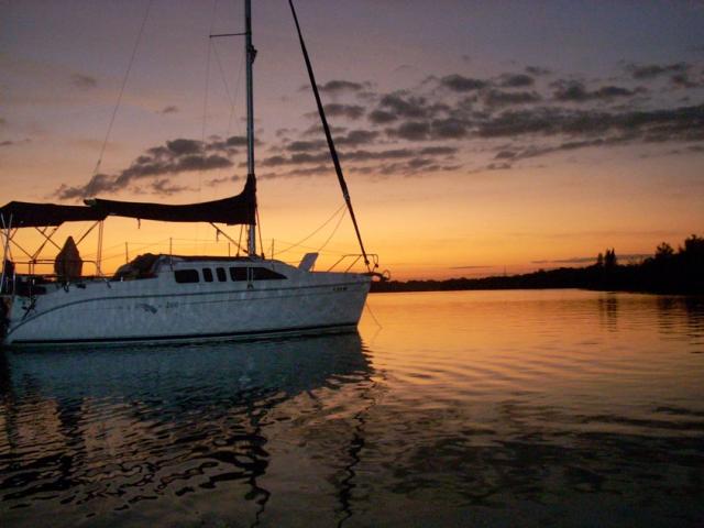

I choose each nights anchorage with great care based on weather, tide and shelter. These boats give us awesome gunk hole choices that most sailboats will never begin to use. pic below in 2 1/2' of water with the Gulf 100' behind us over a dune. love it.
