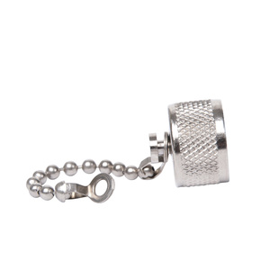

Aug 1, 2011
3,972
Cover caps may seem extravagant, but it really takes little water to start the corrosion process. Cover caps are a necessity!
