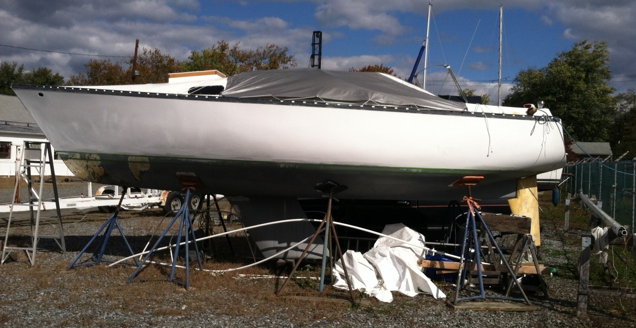

Hello, all. Before I jump off the dock and commit to painting this boat's waterline stripe, I wonder if anyone with a first- or second-generation (1974-1979) H25 would care to share some dimensions on the waterline stripe.
The accompanying pic shows my current tape markings. These came from measurements taken from a sistership parked next to Diana. The sistership was totally stock with little gear aboard and had a near-perfect slime line (actual float line as defined by water marks). I have already cheated this stripe up about 3/4" but dislike how low it appears at the turn of the bilge amidships.
Would anyone like to contribute actual measurements of other boats?
The best data would be as follows:
  • Bow: hook tape over edge of deck, next to stem plate, keep in contact down the stem and report the reading at the forward end of the actual float line.
  • Stern: hook tape over corner of the bottom of the transom and report the reading at the aft end of the float line.
  • Midships: any reading taken from any measurable place (such as at the after chainplate/shroud pin); hook tape over TOP of aluminum toerail, keep vertical and report reading at top of actual float line.
This is just to check my marks. I admit I'm probably being just OCD and over-worried. When I sanded and faired this hull I lost the molded-in line, which was fading anyway. I took the measurements from the sistership beforehand and recorded them in a chart, which I will make available to anyone who asks so long as I can 'prove' the data I have. My very worst fear is to paint a line and find the boat floating ON it-- the boat always looks more buoyant to reveal a bit of bottom paint. I have not modified this boat very much in terms of adding weight; but you never know.

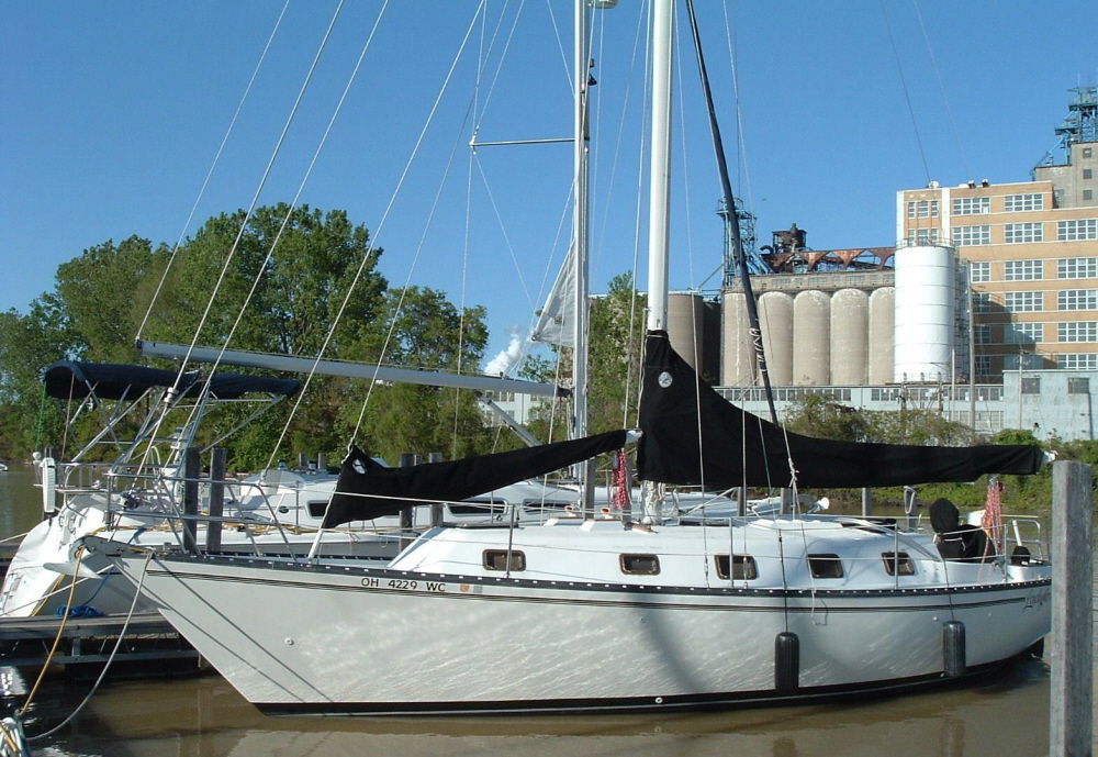

John, I think I can see the line well enough in your picture to lay the tape down. It looks like the right shear and the correct width. I like the looks of a waterline stripe but I have to eliminate mine. With my new motor being so light I am now bow heavy. I think I am going to take the bottom paint to the top of the stripe. I get a lot of slime high on the waterline. Hard to see how that will change this picture.

Ed, how high does your boat float at the stern? That stripe looks pretty level at the middle suggesting the stripe is angling down towards the front. I've seen it before.
As for mine, I don't like how high the boat seems to want to float in the middle. There's too much turn to the bilges above the stripe. I already expect this boat to lean to starboard owing to weight placed there-- one reason why I'm putting a smaller water tank that side (and emptying it first!). The tape stripes in the photo are already 'cheated' up about 3/4". I might cheat another 1/2" or so-- exclusive of built-in sheer of course.
