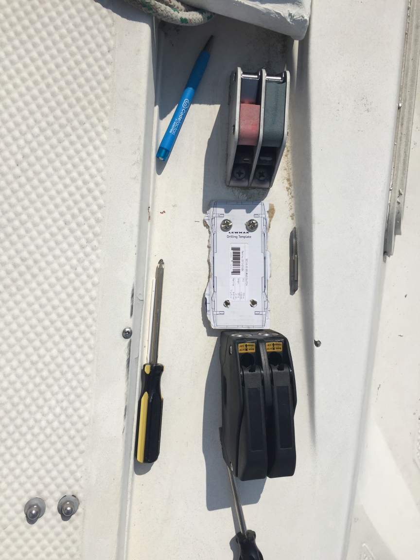

This actually was much easier than I thought it would be. I bought a Dewalt 1/4" tap set (http://www.homedepot.com/p/DEWALT-7-Drill-and-1-4-in-x-20-NC-Tap-Set-DWA1410/204787226) and was able to drill out 4 holes and then thread them. I think there was about 1/4" of fiberglass and then the aluminum plate. The top and sides of the interior have the shiny plastic stuff, so I could determine if the plate was embedded or on the bottom side. I used 1/4" x 1.25" stainless steel screws to fasten the clutch to the deck. Attached picture shows original Easylock still in place and 2 of the 4 holes completed (using the template). Drill bit to the right of the template is the "tap". Once I remove the Easylock and clean up the area it will look fairly decent.

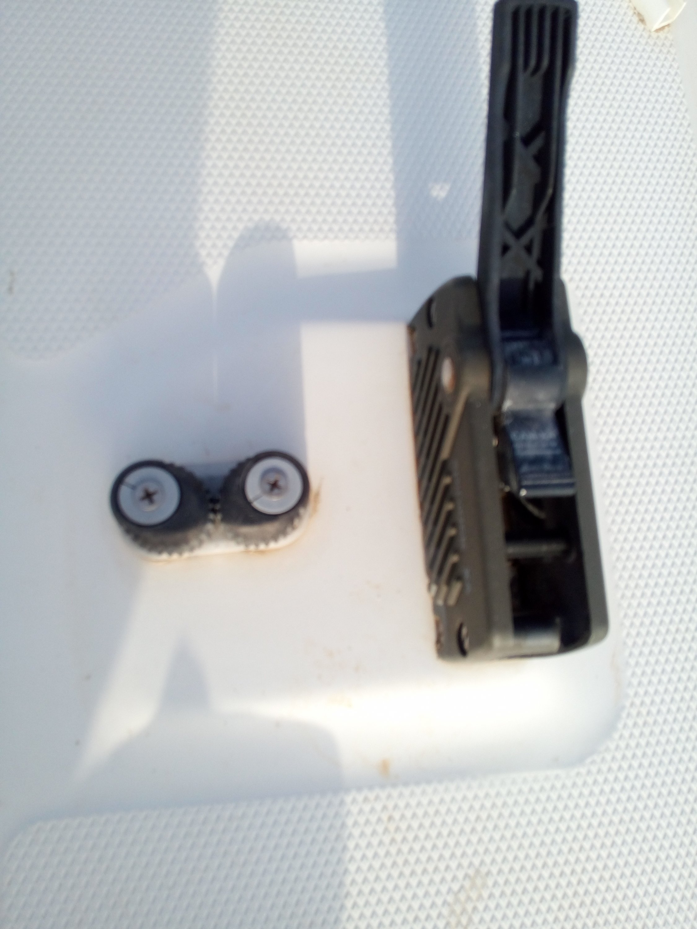

Probably one for you CD, I want to fit a second rope clutch to the Stb side of the coach roof on the 260. Does the encapsulated plate still apply? Thank you in anticipation.

Here you go CD, hope it's what you wanted?
10,536
-na -NA Anywhere USA
You are good to go but do drill a pilot hole first with a small drill bit in the fartherst hole and remember to drill and tap. do not use 5200 but rather a butyl tape or 4200 or any good sealant. Please no bubble gum as I have seen that used a time or two.
