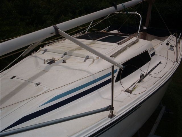

I'm not done yet but the project is far enough along for you to get the general idea (see attached photo). I mounted four nylon brackets for the dodger frame at the outboard corners of the main hatch. The front brackets are conventional but the rear ones are angled to compensate for the slope of the cabin top. All the mounting holes are drilled oversize and filled with eopxy to seal the wood core. Pilot holes for the self-tapping mounting screws were drilled later when the epoxy cured. The frame is made with 3/4" tubing. There are three pieces, a bow over the companionway and two longitudinal tubes from the upper corners of the bow to the front corners of the fiberglass hatch. That way the pop-top can be opened under the dodger while at anchor. The cover will be one piece of heavy, clear vinyl with no stitching except along the edges for the overturn. I didn't consider Sunbrella because I only plan to use the dodger if I need to keep the hatch when it rains, so sun should not be a concern. Vinyl also allows good all-round visibility. I hope this helps. Peter H23 "Raven"

your mast stepping system
Peter I saw the photo in your HOW post Building one for my H23 and I'm curious about your mast stepping system. It looks like the same one I made from plans off this forum. What do you use to attach the a-frame to the lifeline stanchion? I’ ve got the same model and the conduit holders are too big. Thanks for your help. Bob Noble sv Miss Lisa

I used the 1-inch conduit holders because the stanchions are 7/8-inch diameter. If you have smaller stanchions you can either use smaller holders or...use what you already have. The rig works even if the holders aren't tight. If they do get distorted during use, just bend them back by hand or replace as needed. I think they come ten to a pack so you should have lots of spares. Peter H23 "Raven"
