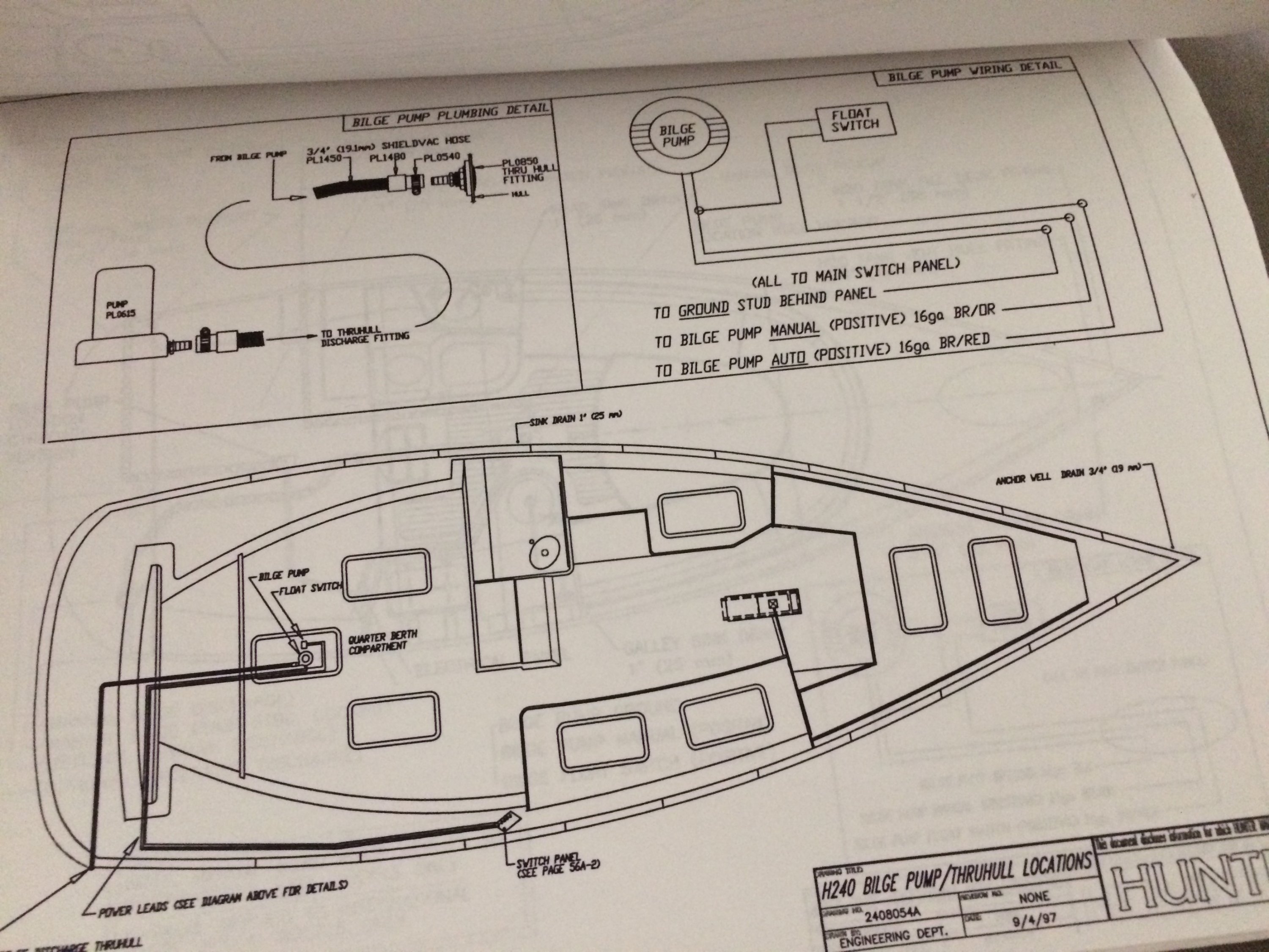

Anyone ever successfully install a shoot thru depth finder in a 240? If so, where did you place the puck? This guy isn't drilling a hole in a perfectly good boat. Thanks in advance.

I just realize I posted the bilge pump. My bad! Look in the manual. It should tell you. The PDF link should do it for you.

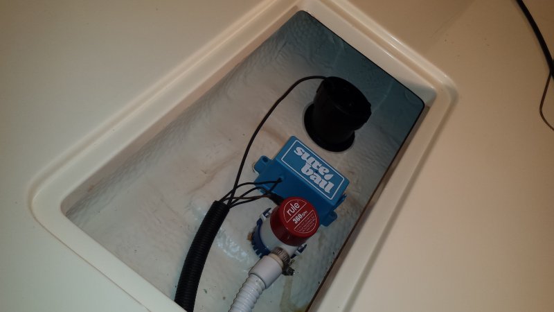

I installed a shoot thru hull transducer in my H26 next to the bilge pump. Looking at the 240 owners manual, it looks like the setup is very similar. You should be able to install one there.
