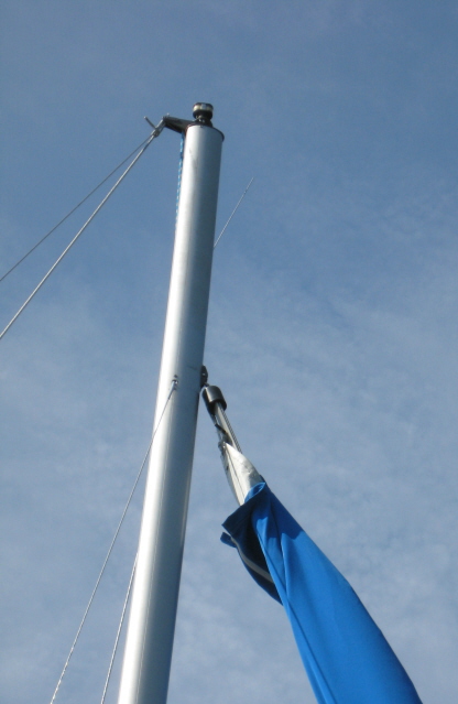

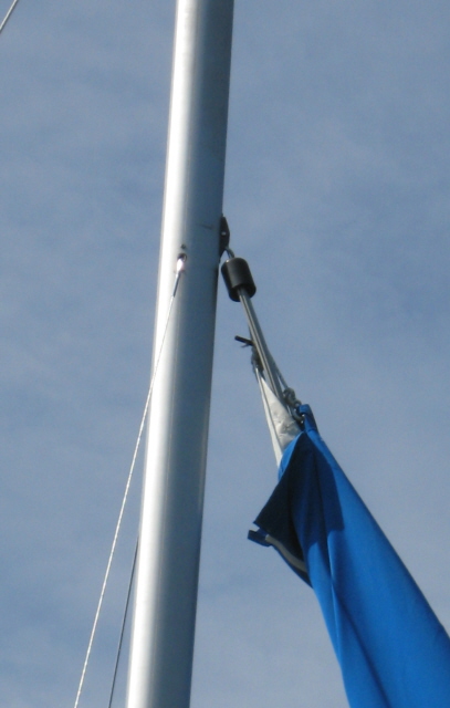

Clark, here is some additional background info with regard to your first three responses.
The mast on my Hunter 23 has no forestay now but has been replaced with the CDI furller.
The CDI furler uses an internal halyard inside the plastic luff and does not use the original jib halyard.
The jib attached to the mast about 2 feet down from the top of the mast, the top of the furler is now located there.
The light line I had installed to raise the sock uses the original jib halyard internal installation and exits at the same location that the CDI furler is attached to now.
I don't know if the sheave is still in place.
I don't know if there is a spinnaker sheave in place. I don't think so!
I think I need to get a close up photo of the problem area for further discussion. I'm just not that familiar with all of the rigging details and am having difficulty.
Look for a photo tomorrow.
Thanks for your assistance.
