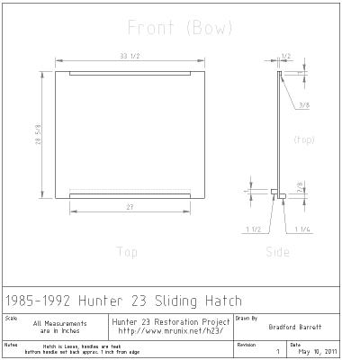

Hey everyone, I whipped up what I think is an accurate drawing of the H23 slider hatch.. having never actually seen one :neutral: , it is based on the descriptions, measurements and pictures from Chris and others on this board. Can you fellow H23 owners with a stock slider give this a once over to verify it's accuracy? It would be greatly appreciated, and hopefully it can help others who are in the same position as I am; needing to fabricate a replacement.
Cheers,
Brad
