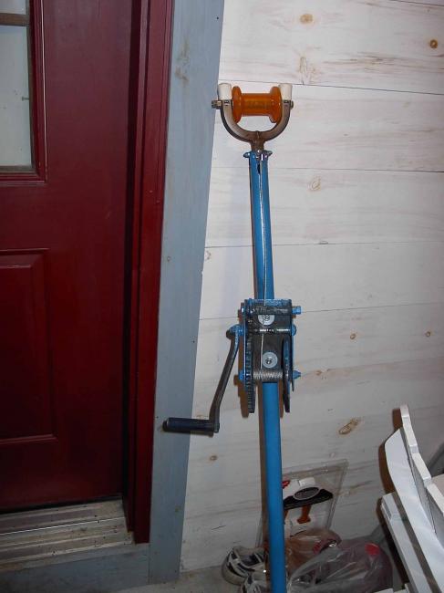

I have finally made the mast raising easier with a new mast crutch. See attached photo. I believe this design was suggested by Peter Suah. I also use the stabalizing system from John Sylvester (see link) as it is quicker to set up that the tripod system. I will post a reply to this with another view of the top of the crutch. With this I can raise and lower the mast singlehanded, though it still takes about 45 minutes.
