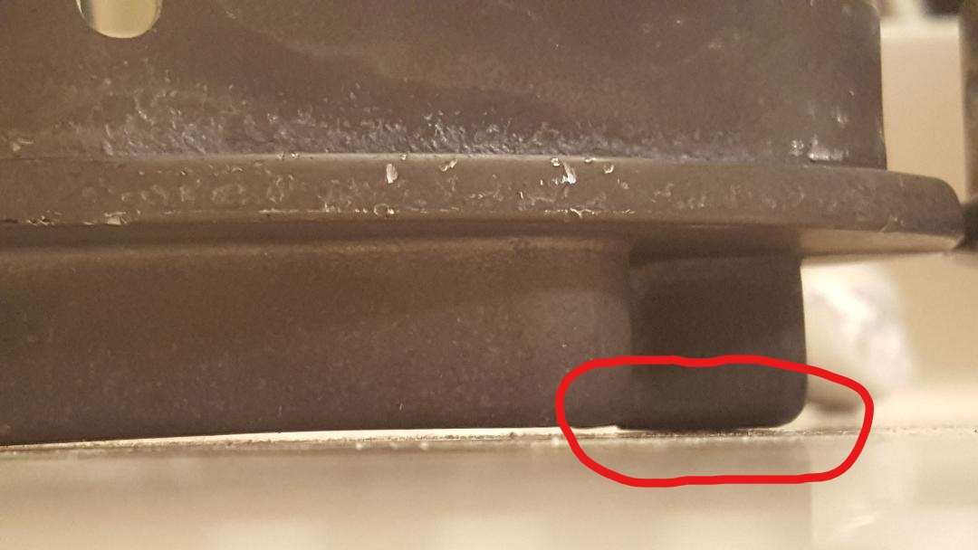

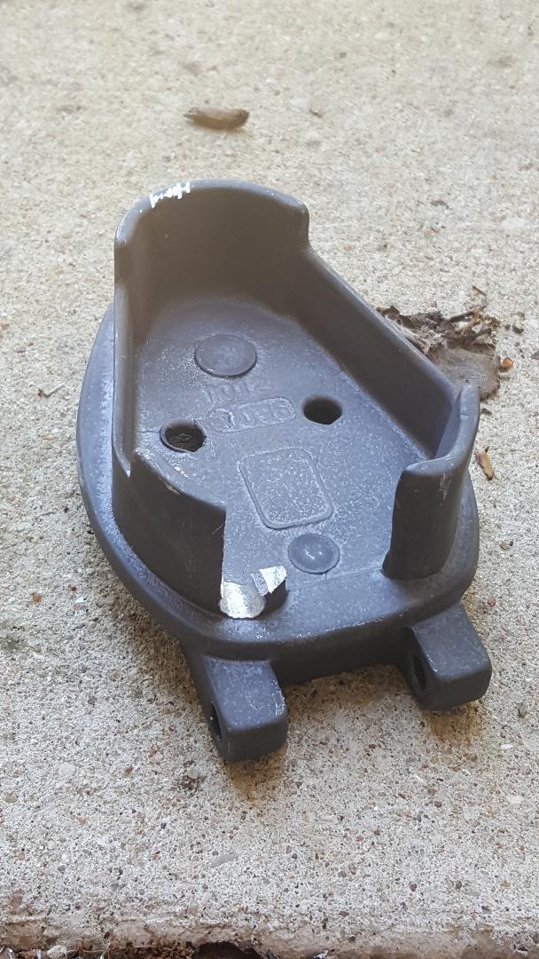

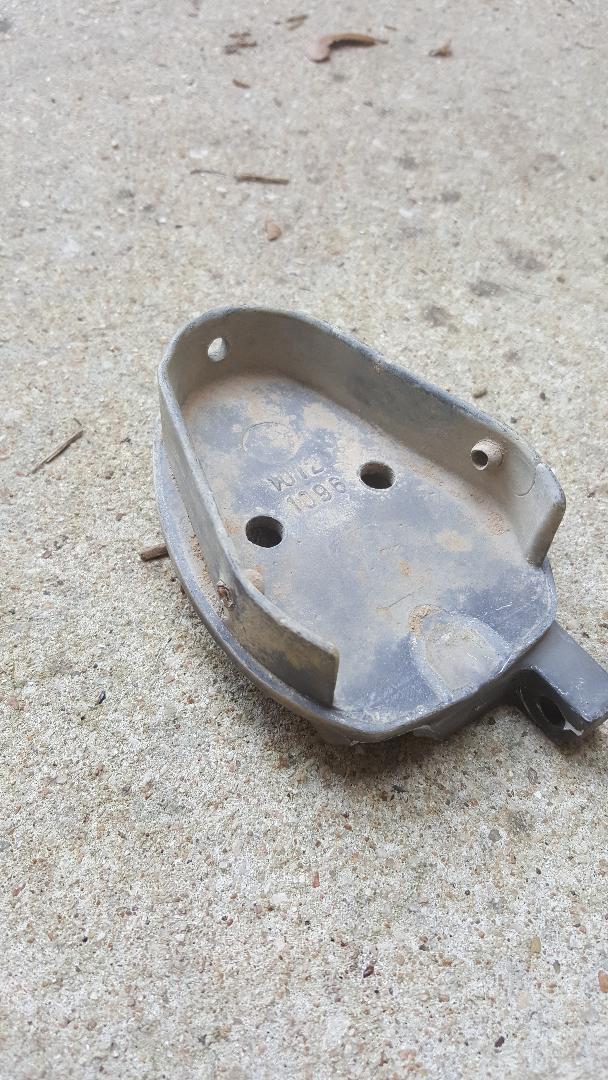

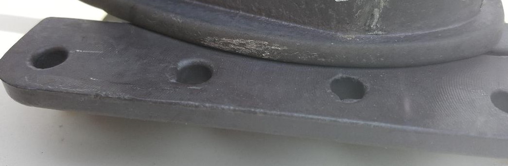

I'm the new owner of a 1990 H23. It was missing a jib halyard so when I lowered mast to fish it, I found the mast foot was broken. The new one arrived, but they don't match exactly and I had to cut out a chunk to get it to fit. Other people on the forum have had a similar problem and did some grinding with out apparent problems.
My problem is now when I went to raise the mast my head stay was 6-8" to short. Before it was getting close to being fully tightened. All other stays were slack. Headstay was straight and fitted correctly. When I did the dry fit on the foot, it seemed to fit flush and tight. The foot is flush with the mast as well. No debris in the step.
My only ideas so far are, I did not dry fit the foot with the bolt inserted and I didn't check the depth on the bottom although dry fitting should have seen an issue there.
Any other ideas on what to check for would be greatly appreciated.
