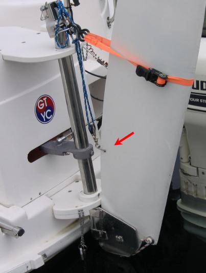

I'm not sure there is a simple way! At least not with the stock set-up.
The PO of Grasshopper drilled through the aft edge of the rudder so you can install a shackle. I pull it up as far as I can, which is the aft edge slightly out of the water, and then use the boat hook to pull it up the rest of the way.
There is probably a way to rig a series of blocks to improve purchase power, but I haven't worked it out.
The Idasailor replacement rudder/tiller for the 23.5 has a great system, but now you're talking several hundred $s. The shackle in the rudder/boat hook system is an inelegant but cheap solution!

The H260 already had a hole in the aft edge for a line. I added a block that makes it much easier to pull the rudder up.

I like the idea of placing a shackel. or maybe a plastic wire tie, on the lower aft side of rudder.It will give me an easy place to catch with the boat hook. As Kevin PO did.
The only question it brings is, will a hole 1/4 or 1/2 hole cause the rudder to break up? Where wouild the hole location be best ?

I considered Drilling a Hole
I was going to mount a pintle to hook a line around or attach a gudgeon to attach a loop of line to catch with the boat hook. I just used the boat hook to pull it up. Try that for a while then if you need to attach a line attach somthing to the rudder to put the line on rather than just drilling a hole through the rudder.
