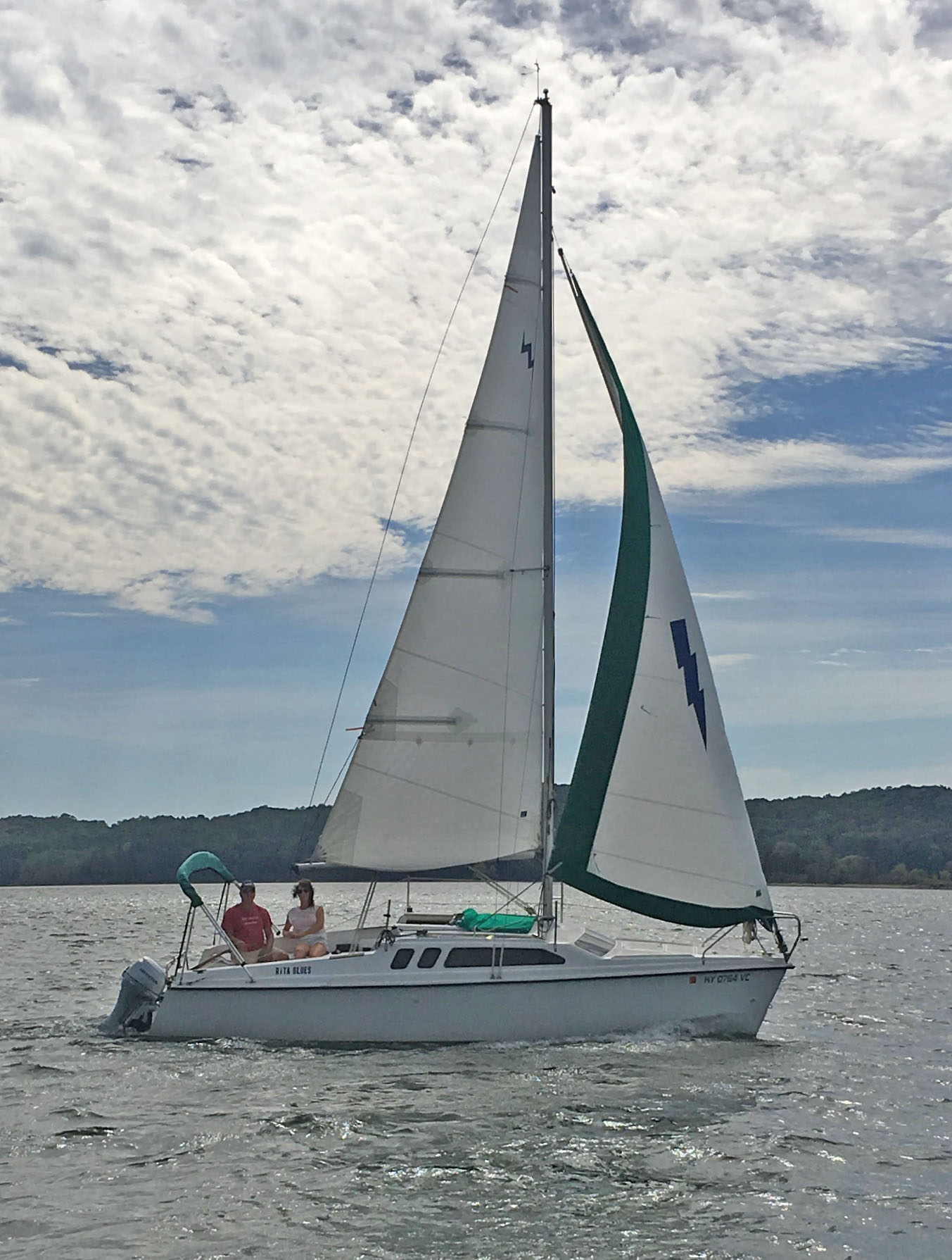

I think I have a 135 on my 23.5. Same as you, that way when I got it. Standard furl is slightly reefed. Its nice to have all the sail for the right winds. Without a jib car you cant always get the right trim. But Im in it for the relaxation on weekends, so no sweat.
In your first post you said the jib was over stressing the rigging. What do you mean by that?

@Sailorjohnca
Your mast is much different as to specs plus it has a backstay. The 23.5 has no backstay so please do not confuse your mast with that of the 23.5. The specs, no backstay, mfg of mast, water ballast vs. keel and so forth are much different from the 26.5 which was built long before the 23.5 which I was involved with the design and introduced the boat.
The 23.5 was initially supplied with a 110 jib as most would say but is a genoa as it comes back past the mast but does not interfere with the shrouds. Anything larger requiring the sheet lines going to the outside of the shrouds is not practicle . Also the 23.5 has no backstay plus it has a larger than standard mainsail. Some suggested with the supplied sails, you might say it is equal to a standard mainsail with a 130 to 140 genoa. @CrispyCringle If your sheet lines are in board of the shrouds with that roller furler, then you have a 110 jib

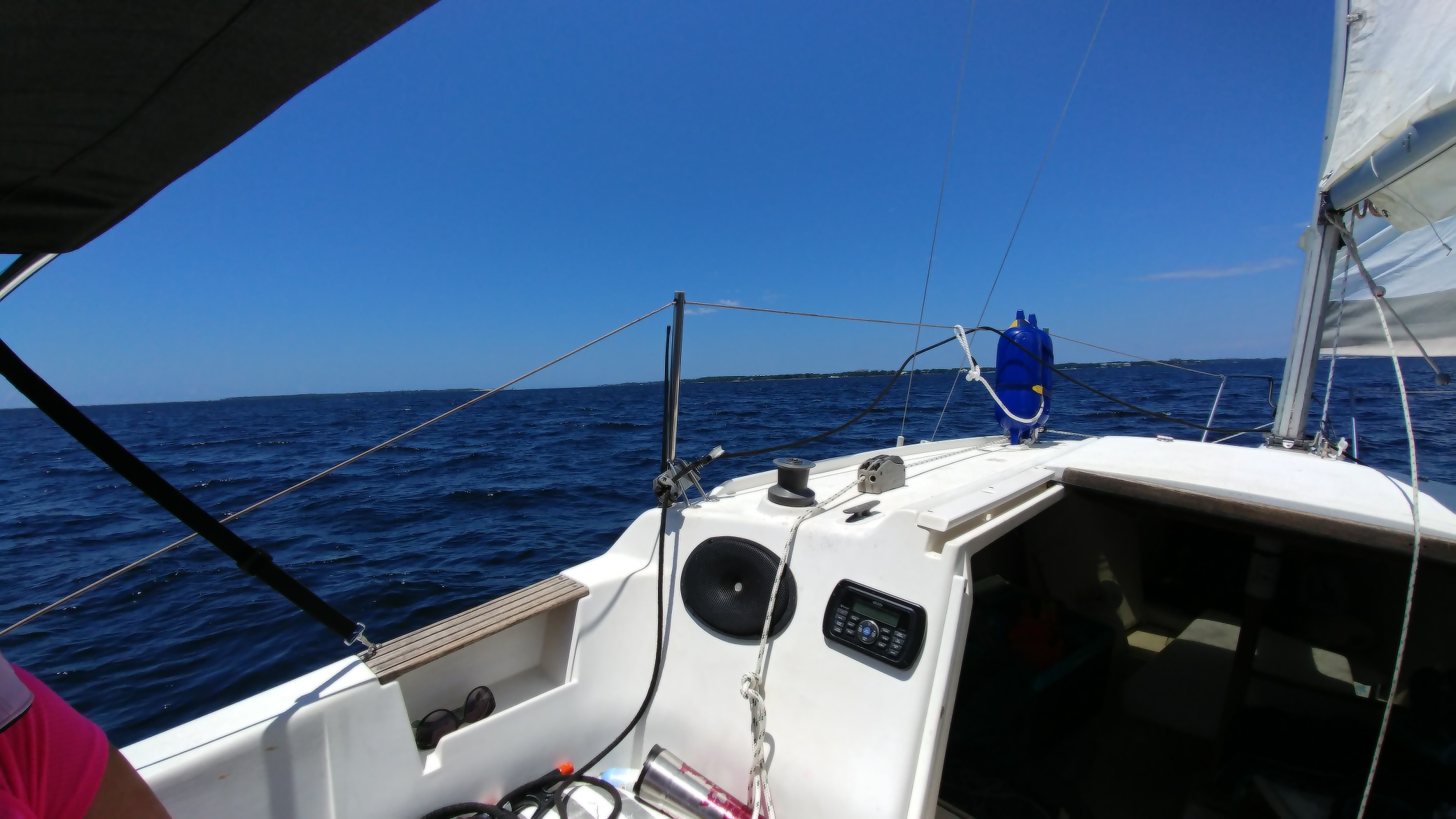

I'm not certain it was the furling genoa or tuning by the PO that stressed the system. Somewhere in here I post pictures of the bend where the stays attached to the seam. Anyway there was a bend or "wowee" in the structure so I had a longer piece of stainless steel made for extra support. If I can't find the pictures here, I'll repost in this thread. Above is a picture of the sheet rigging for the genoa (also added by PO.) the lines are outside the stays.

You will need to post photos as I am not clear as to what your are saying. How about some side views along with this so called part added. In addition are your jib sheets run inward of the shrouds or between the shrouds and mast. Maybe one photo with the sail fully deployed would help me figure out better what you really have.
