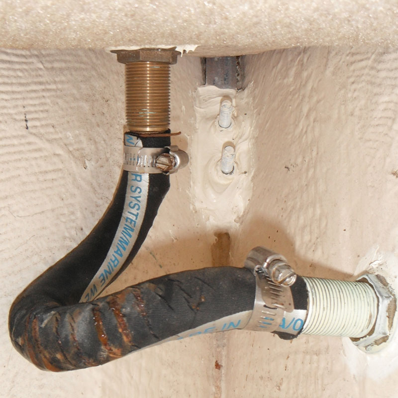

Check the cockpit drain hoses. reseal stanchion bases. reseal mast base. check drain hoses from deck scuppers for cracked hose or loose clamps. tighten toe rail screws. check the thru hull for sink drain. I know not rain problem. reseal blocks for jib sheets. I have done all this to mine and reduced leakage considerably. Cock pit drain hoses can be replaced using flexible radiator hose from advance auto.

I had a about the same thing I ended up replacing all the hoses the biggest was the deck drains and through hulls on top. And check the cockpit drain hoses. Run some water in the cockpit drains and get a flashlight crawl up in the starboard side. All my hoses were bad.

Be careful with radiator hoses. I used one for my cockpit drain on a H23. I used the one that had that steel sping insert to keep it form kinking up. When I took it off while the boat is out, i noticed the coil inside ws rusted bad. I bought the same hose again and got thinking if the coil rusted again, and failed, the hose would kink and stop the drain, possibly sinking the boat. This happened to a friend of mine, bad day. It could also catch crap that gets washed down there and stop up from being rusty.
It is on the mooring most of the time and will sit on its side once in a while. I went to the evil empire (west marine) and bought some of their white flexible reinforced hose. Works great and seems like it will have more long term integrity. I have radiator hose in my anchor locker drain with the same rig. I will be getting rid of that too.
Apr 30, 2011
66
Hunter 22 Lk. Normon, NC
Where ever you get the hose make sure the inside is smooth no ridges. I bought some marine grade drainage hose. It wouldn't titan down enough to stop leaking.
