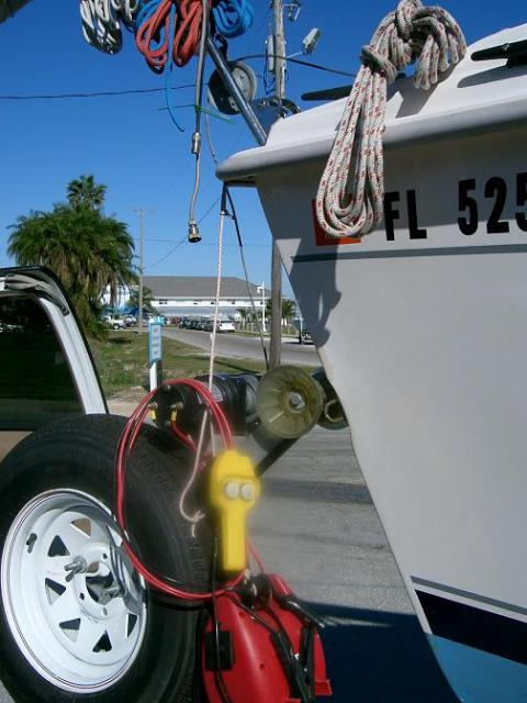

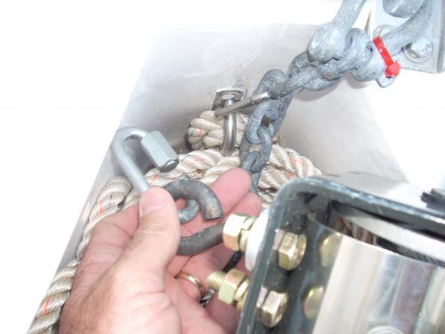

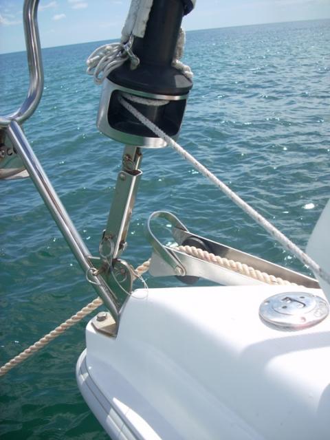

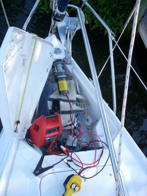

I've been using a removable harbor freight winch w/remote for over 4 yrs. On our old 240 a yr and then 260 for 3. I only use a small 12v jumpstart pack and it's been a perfect combination. Simple, portable and safe. The real secret is the folding closure from CS Johnson that tensions the forestay. Every time I use it I'm amazed how well the whole thing works. Well worth the design effort.
One of the pics is our winch system for the 240 mounted on the trailer, the rest are for the 260 from the anchor well. Your 216 would differ of course. Be safe and good luck.
