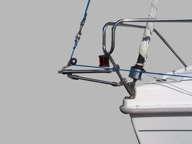

Incorporate
Paul,
Since you are going to fabricate a bow pulpit specific to your boat, why not incorporate all your needs into the hardware.
Here's how Hunter designed our bow. The "U" shape holds the mast when on the trailer. Ignore the hardware I added for the Aspin.
Sep 1, 2007
98
Hunter 216 Deltaville, VA
Re: Incorporate
That's pretty cool. Wonder if I could leverage that same approach and use the front hardware where the furling drum is attached. There are a few extra slots that may be able to support the front of the pulpit. Thanks!
