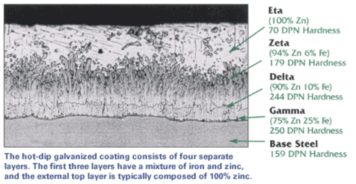

Make sure it is hot dipped galvanized and not just galvanized. Big difference in corrosion resistance.
+1 on the hot dipped galvanized. Found a nice image of the cross section of hot dipped galvanized:
Hot dipped galvanized is the only form of zinc coating that has the 4 distinct phases found above. All other methods only produce Eta phase, 100% Zn. Note that the Eta phase is only about 70 DPN hardness. That's pretty soft and zinc coating can wear off fairly easily, especially on anchor chain. Look at the significant increase in hardness as you go down in the different phases. Once you wear down, through corrosion or mechanical wear, to the Delta phase, the coating hardness is getting pretty hard, in fact, harder than the base steel. This base steel is not a hard steel, more of a normal mild steel. But that doesn't affect the zinc phases. Once you get down into the Delta phase, the chain may begin to get a rust like reddish coloration, but in fact, the base steel is still being protected through the zinc coating.
Just a FYI....
