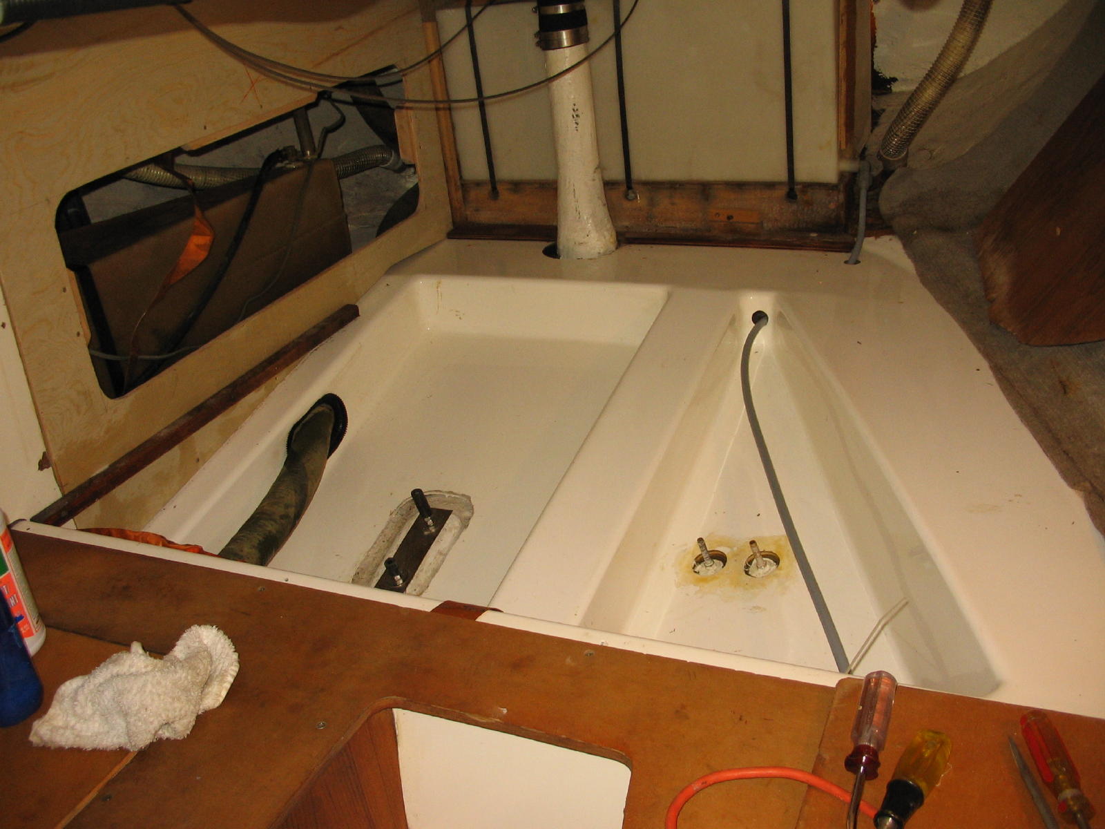

Aug 10, 2020
29
Hunter 34 Austin, TX
same here. previous owner did a hack job with the quarter berth wall. access to the locker from here is actually quite good (batteries, etc) so when I redid the wall I kept an access door. It's hinged with locks so it stays closed. Below is the only picture I have from when I did some rewiring, so ignore the cables, the door shuts completely and you can't really see it then.
