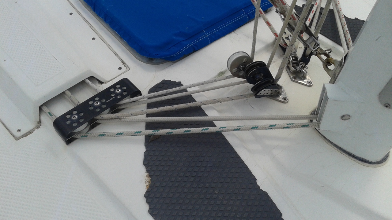

I wanted to bring halyards, reefing lines, downhaul and outhaul to the cockpit so I needed to replace the deck organizers on both sides. I did not find a direct replacement but since there is an aluminum back plate embedded in the fiberglass, it was not a big issue to align the new organizers (Schaefers). I used one of the two holes, plugged-up the unused one and drilled another one of the same size where needed, taping the embedded plate to accept the holding bolt (IIRC 1/4 - 20). See pics

Looks like what I've been looking at. Are those 5 series or 7 series? The 2 sheave. Wasn't the correct spacing? Good to know there's enough aluminum plate to sink another hole if I need to.
