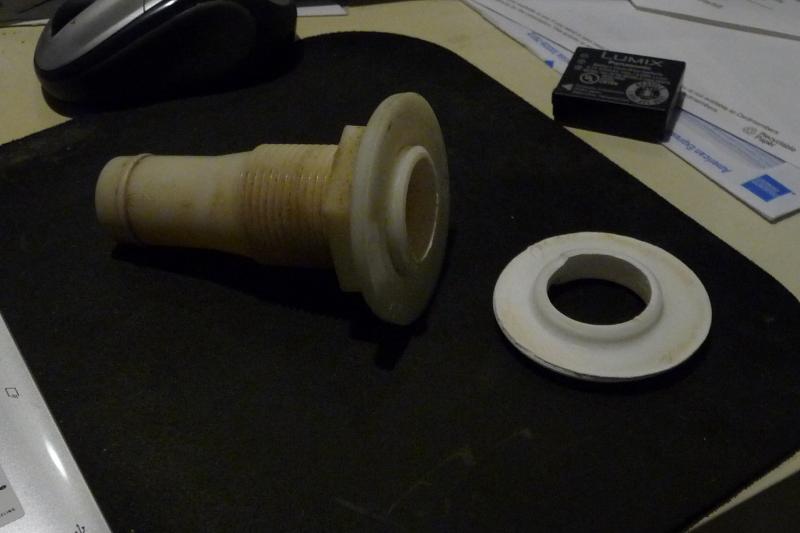

Original bilge pump outlet (30 years old) broke this past weekend. Hose sagged down and bilge water was pumped aft to the stbd locker where it went on the floor and trickled back to the bilge then aft again. Picture is of broken fitting.. an old nylon one, I think.. I replaced with Marlon. Going into the pit is never fun ! Everything dried out well.. MAN ! I am glad we went there to wash her down over the weekend and caught this mess before it got out of hand and ruined the floor.

Same thing happened to me. Like you, I was lucky in that I noticed it before it became a mess. I replaced the through hull with a stainless steel one and the hose with the stuff you use for the head instead of that cheap plastic ribbed stuff. So, how you do you like crawling down in that hole? I am considering making a nice, big access hatch from the aft berth through that plywood wall.

Yes, going to go with better hose too but not just now. That is on the list.. I agree, the stainless is MUCH better looking and about the same price as the Marlon was at West M. But they didn't have anything but Marlon or nylon..

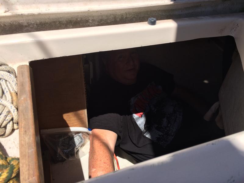

That hole is not easy for a fat boy (6', 260#) to get into !

I'm a skinny old guy and I have a tough time getting into and out of the "dungeon"--how the hell do you do it!

Once you are in the pit it becomes a bit comfortable, nice, quiet and nobody bothers you. good to have a cell phone to call 911 if you can't get out. Great place for my son-in-law. Just kidding, but he does fit better than I do.

Laughing.. thought I might get some"pit" observations from the post.. Allan, I have a Whaler set up that can be pumped from the cockpit while driving.. but I have an air conditioner in the locker with the water heater.. so I can't do much in there.. My air cond pump discharge is directly under the bilge pump outlet, only it is about 4" above the waterline .. Judging from the dirt in the fracture face on the old Perko 301-6 fitting, it probably had been drooling a little for a month or so.. Since my air cond on "dehumidify" (on when I am not there) drains into the bilge, I really can't have that kind of water mess going on !

I'm 6'1 220 and had to change out the exhaust hose. Getting turned around down there is a pain. Made sure I had my cell phone in case I got stuck. I will now keep an eye on the bilge pump thru hull.

6'1", 215#, and have gotten stuck for a bit. I remove the wine glass storage and put a microwave there which acts as a shelf for the cell phone to rest while I work down there. I think my bilge outlet is farther forward on the STBD side. I do plan to install a manual bilge pump, just not sure where. I saw where Chris has his on the sink base cubby, where I have a fire extinguisher. I might do something like that.

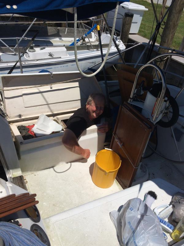

Yup.. I don't wear a belt if going down there.. note jib sheet tieing lid open.. If I am alone, cell phone is on the little internal shelf so I could call for a fork lift and a quart of cooking oil ! No way I could turn around and get to the exhaust hose end!.. I did recently change the fuel return line to the aft of the tank.. that was fun too.

Getting to the exhaust hose was an ordeal!! I had to get my feet in just the right spot and push my head past the cockpit floor. My back hurt for a few days after. Hope I don't have to do that again. I am glad I am not the only one that struggles with that damn hole.

I've replaced every vent. Like you, my bilge outlet fell apart one day. I checked both shower outlet and head vent and they both fell apart in my hands as did the diesel vent, rear fresh water vent and main water tank vent. Okay, I'm finished venting.
