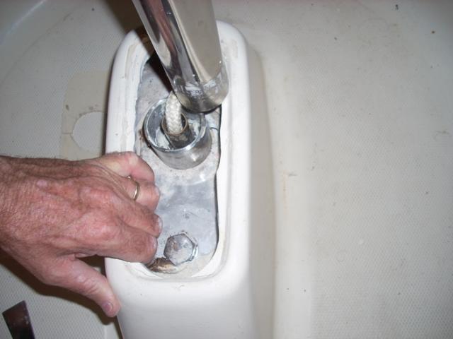

* caulking around the hull/CB riser and floor liner seam under the table by CB bolt(no water leaking there)

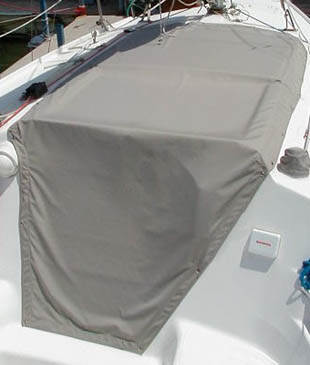

* Installed full hatch cover/companionway canvas (very effectively stopped rain driven leaks)
