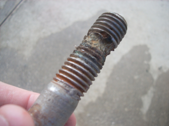

Brian, Good luck fixing the leak. I had a particular hard time finding one on my 1999 H260. This may not apply to earlier models. At the stern, the wiring for the stern light was run through a drilled hole and calked. After a few years, I started getting intermittent water in the aft berth. It turned out when a wake or following wave came over the stern it could run through that hole. Caulk solved the problem.
If you keep your boat in salt water for long periods of time, I suggest examining the keel bolt AND the mating nut (that may welded into the swing keel bracket - it is on my boat) for corrosion. When dropping the keel to repair a center board up-haul line, the boat yard noticed corrosion and replaced the bolt, but not the nut. A few months later the nut failed and I have to go through that whole replacement process again. For boats stored in salt water, I suggest planning to replace the centerboard control line and retaining nut and bolt about every 6 years. Don't wait until it fails.
Question for Dave C. Would it make sense to flip the center board retaining nut & bolt so the nut is up inside the boat, protecting the threads from the salt water?

When I pulled the CB 18mths ago I was pretty shocked to see the corroded condition of the main 3/4" ss bolt. (see pic). There were no other signs of serious corrosion on the boat and no signs of a lightning strike but that much material missing was pretty alarming. There was no corrosion on the CB bracket either. It's possible that Hunter unknowingly got a bad batch of bolts (or maybe just one, mine) so it's a good idea to check it out sooner than later.
As a side note, Someone here once mentioned using a 16" piece of 3/4" all-thread to re-align the CB bracket bolt into the compression post plate and it's one of the easiest time savers that I used when doing mine. just screw it into the bracket, push the assembly up into the well guided by the all-thread and simply unscrew it from inside to find the hole perfectly aligned for your new mounting bolt.
