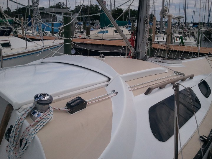

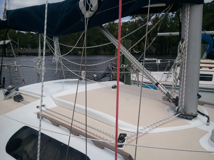

Hi Db421
I have a 1974 Hunter 25 and this is my setup

suds
Nov 16, 2010
36
N/A N/A N/A
It was installed by the PO, however I did have to do repairs prior
to painting the deck. To me it looks like they fiberglassed a PVC of some type on the cabin side. When I did the repair I used West Marines Structural Filler (we use to call this stuff tiger hair) and then Evercoat filler to create the smooth surface.
I painted the deck with Interlux Brightside, since I was unsure of the previous paint type.
