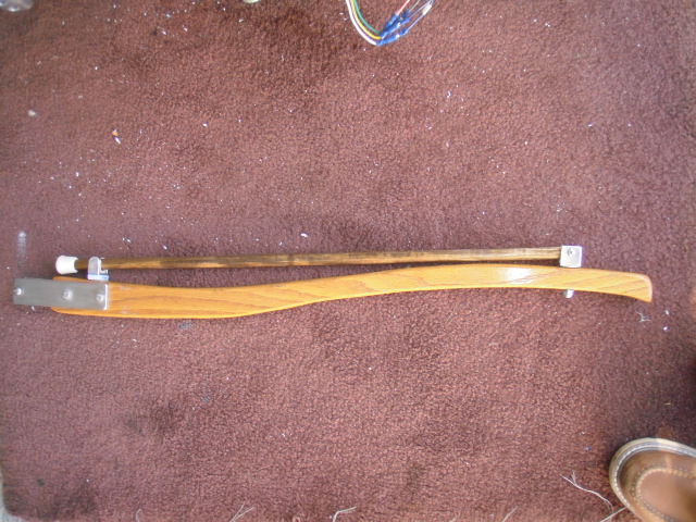

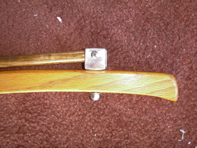

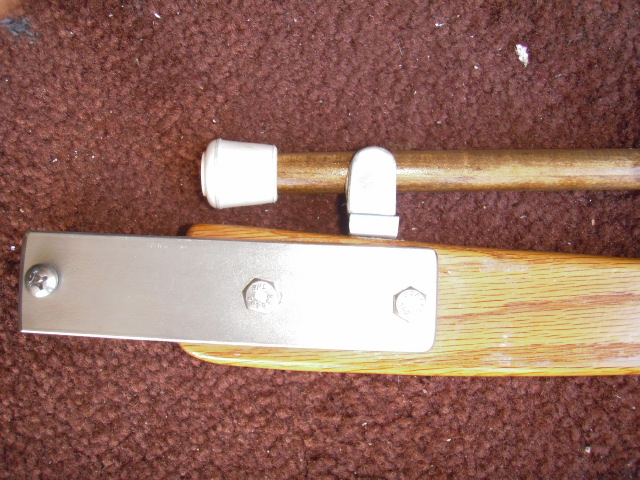

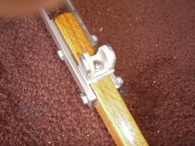

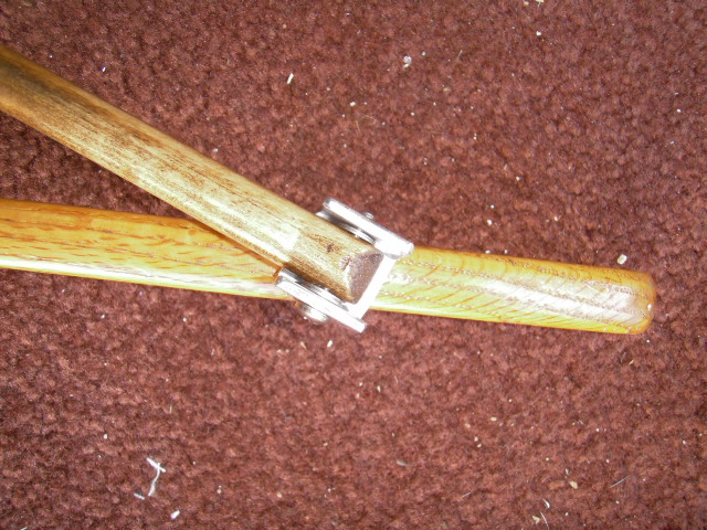

i made this tiller extension using a 5/8 hard wood dowel, 1 inch x 1 inch aluminum channel, i thru bolted a 1/4 bolt in tiller left it a little lose for it to swivel, works great cheep
