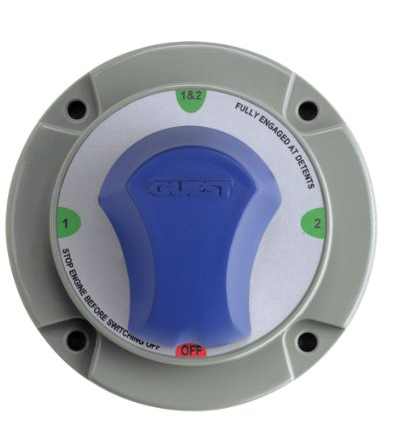

I personally like the Perko which has a 110 degrees throw switch instead of the 360 degrees of Guess. Any OFF, 1,2, All switch will do. Make sure you get a "make before break" switch to safeguard the alternator. When switching they will make a connection before rupturing the previous one.

This is supposed to be the one you have, does it look like this?
No, mine looks more like the red Guest one, but it is all black. Pretty sure it is stock because a friend of mine has a 2003 Hunter 356 (one year older) and it has the same battery selector switch.

The only real spec on any of these is the current carrying capacity. I believe you want the 300 amp continuous if the starter power runs through it. Also the make-before-break. That is pretty much standard on all versions now though.
