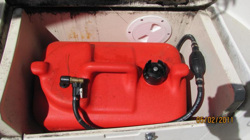

The smartest thing I ever did to my boat several years ago was to install an 8" Beckson Deck Plate in the center of the inside transom on my O'Day 222. I was able to remove both of my gudgions, re-caulk them and reinstall them all by myself. It also came in handy to replace my self bailing cockpit hose. A friend of mine gave his outboard bracket this past summer and I was able to access the nuts washers and backup blocks through the deck plate to install the bracket. The holes lined up perfectly and I was able to do this job by myself. I'm not sure if it would be applicable to an O'Day 25 but it's worth looking into.

I just recently mounted a 4" Beckson Deck plate in my fuel compartment to gain access to a jam cleat that I mounted on my combing near my stern rail for my furler drum control line. I can also get at my stern cleat nuts and washers now where I couldn't before. Deck plates are great.

Trinkka, you got me convinced. The next time weather permits, I'm putting on a deckplate similar to your set up on your 22. It will help me getting to the cockpit drain hose, gudgeon bolts, gas tank and fueling hose and exhaust port. Is the port below your tiller also 4 inches?

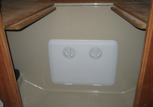

Or you could put in something like this (found it on a clearance sale for $20).

I would even go one better and see if you can find something like Rich has pictured. If you have to beef up the inside of your transom with plywood or do any glassing, you could probably just get away with the full face respirator without the need of going in there with a bunny suit.

Rich, you got a great buy on that. I think I paid about $20 for my 8" deck plate new at "Worst Marine" years ago. That 4" Beckson Deck plate that I just installed in my fuel compartment cost me $5 and the small jam cleat was $2 at a marine consignment store in the Newport RI area.

Rich's hatch is nice , but there is no way you are gonna get a 30" piece of plywood through that!

RBone, That is impressive. But that hatch is inside the cabin, giving you access under the V-berth, right? I might be a little apprehensive about cutting that big of a hole on the cockpit side of the transom.
