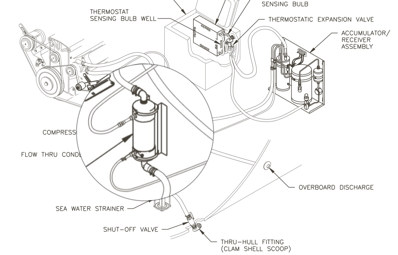

Sorry guys. Maybe I am not explaining it well. I get what the condenser is and how it works. It is NOT leaking from where sea water enters and exits. But from where the refrigerant tubes enter and exit. If you follow the link I posted, and look at the photo, you will see the cylindrical condenser on the right. There are two fittings sticking up in the air. Where those fittings tread onto the housing is where it is leaking. They certainly appear to be original equipment. They appear to be compression fittings around the tubing where it enters the housing. Screwing onto to the housing to keep the sea water from leaking out around the refrigerant tubes. From the threaded side. I am just trying to make sure that if I unscrew them I am not going to cause a refrigerant leak.
I did this from that manual you linked.
The skinny lines are refrigerant lines.
I would take a close up picture of the culprit connections to the "Cooling Tank" leaking seawater and call Dometic in Pompano FL.
You will get an operator and ask to talk to a Grunert Technical Service. I have done this.

That condenser tank, per manual, comes in different sizes and sold as a unit.
