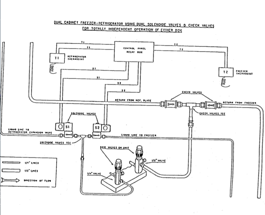

Here a faded graphic to help, I hope.
S1 solenoid is controlled by the thermostat in refrigerator.
Test...
1) Turn both thermostats OFF.
2) Wait about 10 minutes.
3) Turn refrigerator thermostat to coldest spot.
If that starts your compressor then the thermostat is good. If the single refrigerator cold plate does NOT get cold, then it is probably your solenoid.
Jim...

It looks like from your diagram that the solenoid needing to be replaced is in the same compartment with the compressor and the control unit. Does anyone know if this can be replaced without having to recharge the system? I am trying to figure out if this is something I can do on my own or if I need to call a refrigeration technician?
It is most likely the 12VDC activator and not the valve body itself. So no refrigerant lost.

Update as I have additional info....Unfortunately yesterday I was able to remove the Solenoid body and confirm with a metal screwdriver that the magnetic field activates with the 12v dc current. So it appears that my problem may lie in the valve body itself?
Ok, good trouble shooting.
But you can confirm the valve is working manually too.
Lets make sure we have our terms right or you can call me by phone.
1) Solenoid is the 12 VDC actuator you tested
2) Valve is the "valve body"
The solenoid get power from the Power BOX
The Power Box circuits gets information from the thermostat.
So with the Solenoid off the Valve but still connected to the Power box you should see the solenoid activate when the compressor starts up.
I seriously doubt you need to call a refrigeration tech yet.
