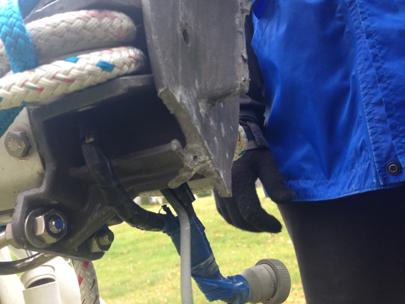

Got my boat lifted and set on my trailer this week. 1987 Oday 272. I store it in my shed over the Winter. The marina lifts the boat and uses a truck-mounted crane to unstep my mast. I carefully explained that the mast had to be laid to the stern to a 45 degree angle to allow the pin in the base plate to slide rearward out of the base. The crane operator snugged the crane boom against the mast but with the head beyond the mast, and he had the yard hands pull the pins on the stays and shrouds. He did not adjust the boom upward or inward to snug the sling against the spreaders, so the mast immediately leaned 15 degrees to starboard, toward the boom head. I was yelling as they did this that they could not let the mast lean to port or starboard, or it would tear the pin out of the deck plate. I was wrong... not in a positive way. The lean on the mast tore the lobe, which holds the pin, off the mast base. Pretty substantial damage, but my base plate is still usable. As long as I do not step the mast myself, the pin, and the lobe on which it is mounted do not function during sail, and so do not hinder me.
I am disappointed. The crane operator said it was my fault because my sail was still on the furler foil, and that somehow inhibited the use of the boom. I do not understand. I do not agree. I held the foil/sail out of the way of the boom. He did not adjust the boom height or extension to snug the sling against the spreaders.

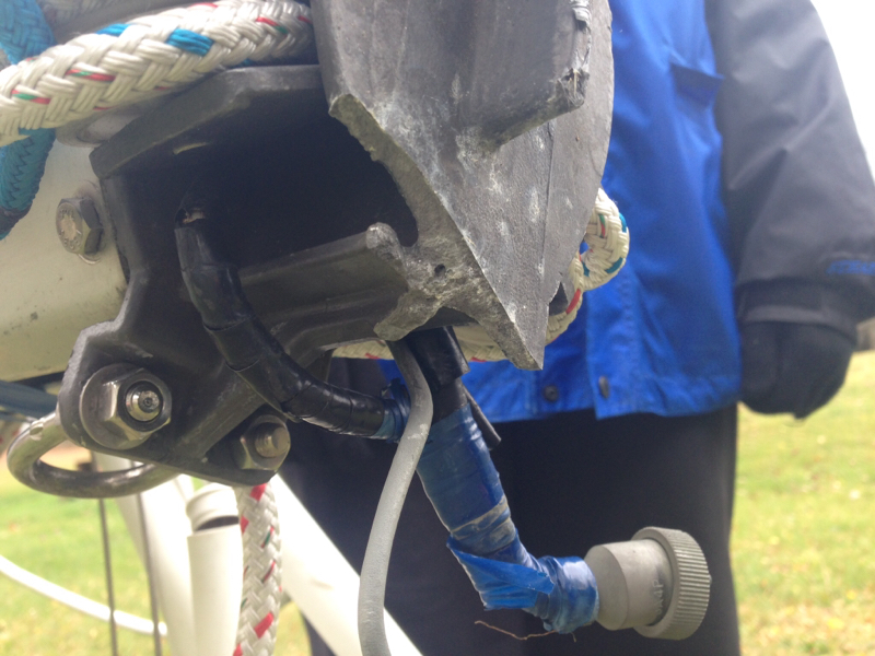

The photos show the lobe and pin on the mast base on the lower right. That entire lobe was shorn from the base.

Can you take the parts to a welder and have it repaired? It shouldn't cost you much.
Aug 3, 2012
2,542
I did think of this. My experience with cast metals is that they are brazed. I have not had experience with cast aluminum. Is it possible to weld a cast aluminum part?

Yes it is, find a good welder to brazen it.,

have it Tig (aka..... heliarc) welded ...they will grind out a v bevel in the broken part and weld it back together ...this insures a full penetration weld ...they can even grind it back to almost new cosmetically if so desired
Thanks! I have done some gas welding on mild steel, but not on aluminum. Happily, there is an excellent fabrication shop nearby. I will take the part(s) there.

Welding cast aluminum is done all the time but one concern. The weld and heat effected zone will not be at the same temper as the rest of the part. You should have the part heat treated after welding to get the strength back.
Aug 3, 2012
2,542
Do I ask the fabricator about that?

Thanks all. I wish I still had my gas rig. I would do it myself. I even found a Youtube video! I will remove the base tomorrow and call the local shop to see if they can handle it. If they can't, I may just borrow my rig back and get some aluminum filler rod from the local supply.
I will let you know how it goes.

yes ask him he will know what to tell you and as far as using a acetylene rig to do this if you have never certified on that process best to let the fab shop weld it ...welding aluminum is an art all by its self and best left to the Tig welder....he should be able to do the job with minimal heat and not fracture the weld and have 100 times better filler metal control that a gas rig will afford......

I broke the base plate on a different type of sailboat and took it to the largest welding shop I could find. The told me it was actually made of magnesium and did a beautiful restoration for a small charge. They said they all have boats and know how discouraging to have something like that happen. They enjoyed the challenge.

Got the base welded at the local fabricator. They did a nice job. I am relieved to have it fixed and ready for use.
