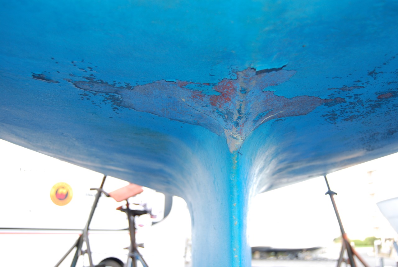

I would add, have your keel seal to fiberglass and keel bolts checked too, if you pull her out of the water.

Went sailing today and the boat sailed perfectly. The diver is coming this afternoon to clean the bottom and prop/shaft and will check out if there is any damage.

Diver report came in today. Slight "scuffing" on the bottom of the keel. No damage to the rudder, keel, or the keel to hull stub joint. No bottom paint removed from the port side where it sat, no leaks from the lower port windows. All is well with the world. Like I said, I had her out on Sunday for a little spirited solo sailing. 12 to 15 knots true. She pointed very well and held course. I had her heeled over a little more than normal but she didn't seem to round up and the auto pilot held her steady with about 10 degrees of weather helm in the 12 knot wind. I probably could have balanced the sails to get to about 5 degrees but it was fun to clip along heeled over like that. Beautiful day on the water - had to get back on the horse after the grounding. Found out later from others that they too had grounded in almost the same spot on the shoal that had extended about 200 yards down the river from where it is marked on all the current charts (in an area that shows 9 feet at MLW).
