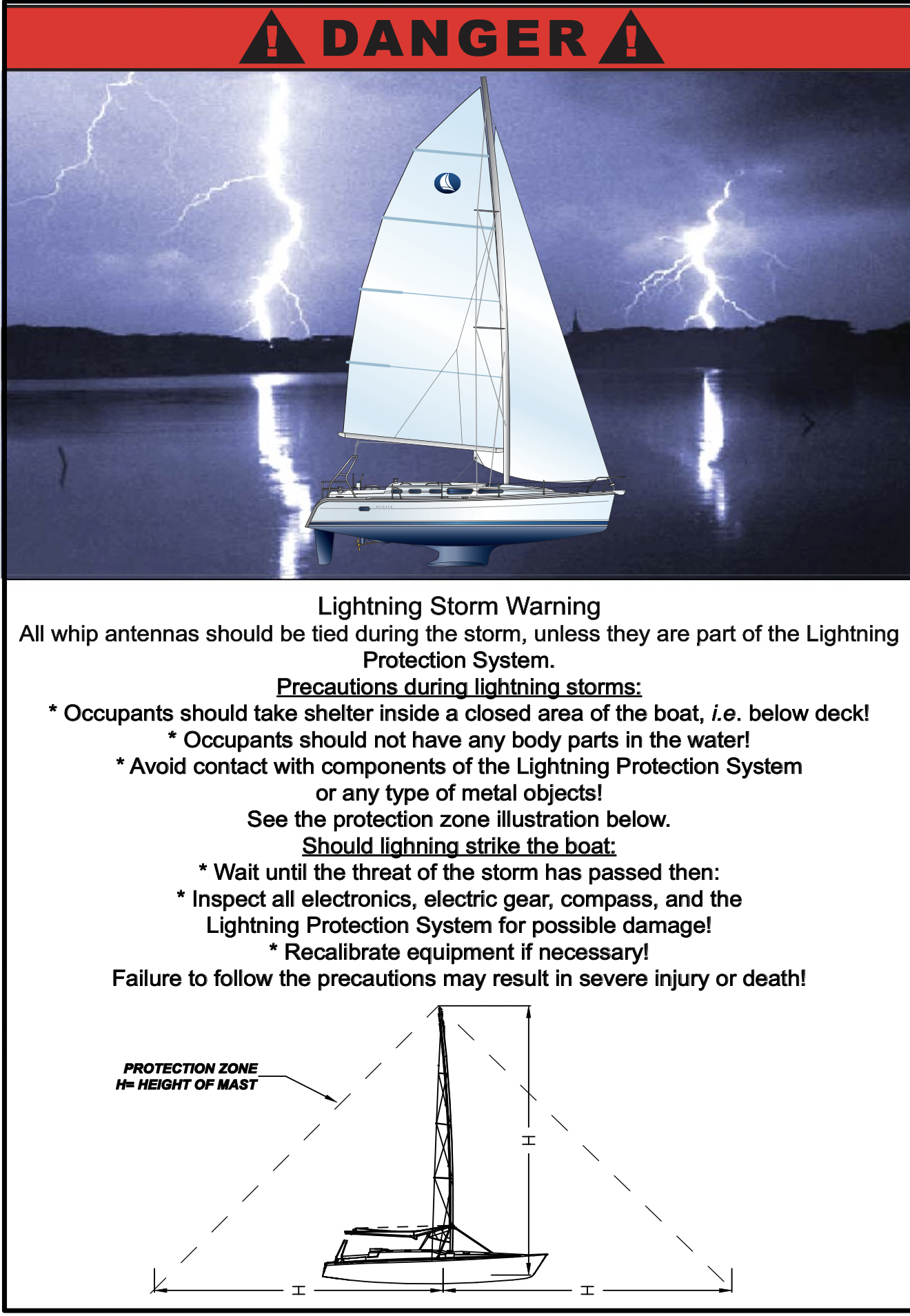

From a large boat Owner's Manual.
That Zone of "Avoidance" is the Faraday Cage effect. [Not Protection]
Jim...
