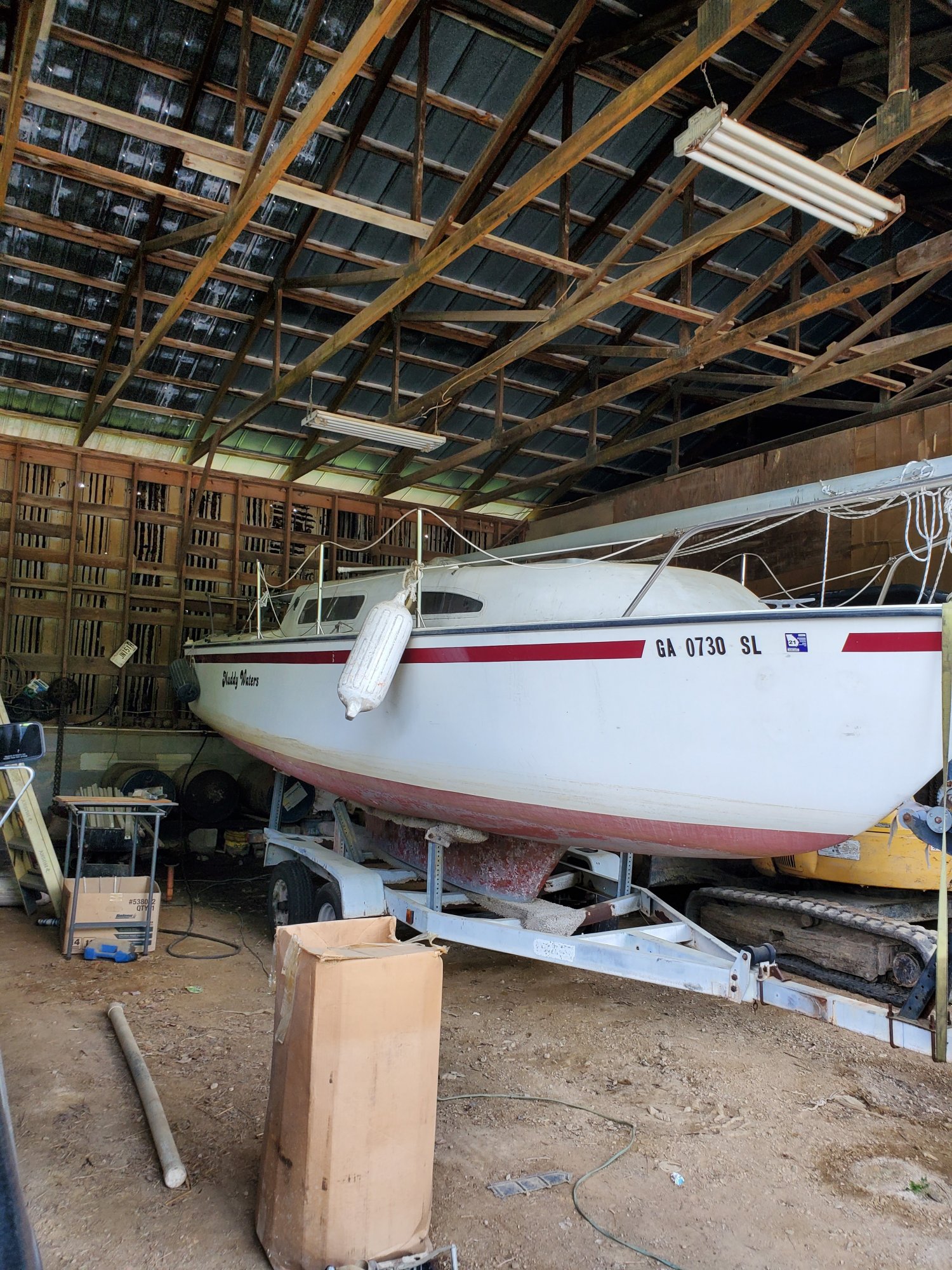

Apr 3, 2021
5
American mariner 8 Chattanooga
I do not have an engine. I am worried about lightening. I am making a camper out of my boat. I have no paper work on my boat.
Apr 3, 2021
5
I was not given any factory paper work on my boat when I took possession of it. I am restoring it completely and do not want to have it damaged.
JamesG161
Feb 14, 2014
7,931
Hunter 430 Waveland, MS
I assume you are camping with the Mast Down.
If so, your boat is isolated from Lightning, if the trailer front tongue wheel is put on something non conductive like a 4x4 block of wood, old Ice chest lid, or cinder block.
Sometimes you can use your trailer spare tire too, if easily removed.
Also you can leave it hooked to the car, no trailer chains dangling to the ground.
Isolate yourself, boat and car, during Lightning storms
Jim...
PS: Welcome to SBO and people can help with most anything, including your boat paper work. Find your HULL ID #, normally a small metal plate on Starboard outside.:cool:
