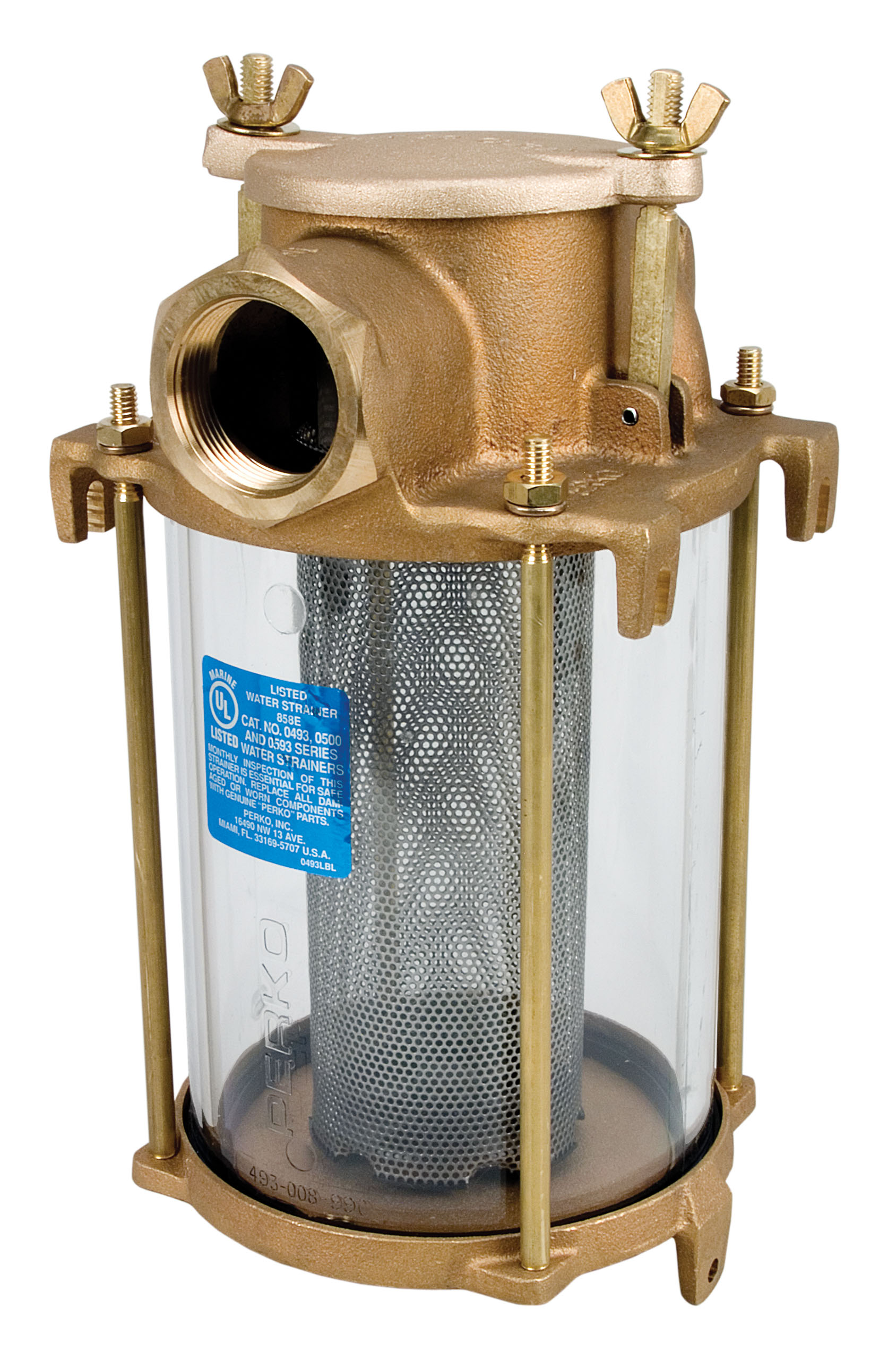

I agree, the raw water strainers Catalina used were not very robust. I went with a Perko
Courtesy of Perko
