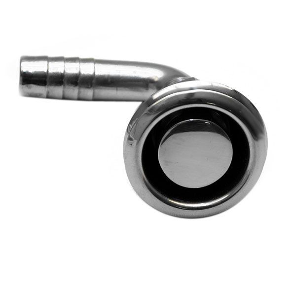

I'm 99% sure I have a clogged vent line for my grey water holding tank. The outside vent looks like this one attached. My question is, is there any way to unscrew / pray off the chrome cover so that I can snake a wire down the rubber hose to clean it out? It's virtually impossible for me to remove the hose from the tank or the thru-hull vent fitting because of the tight space. I've tried using water and air but, neither one seemed to unclog the line.

No, it is a solid piece that has holes on the side with small mesh screen that has probably clogged. If you can not remove the fitting try using a angled ice pick to pry screen out and maybe you could put a wire or plastic wire tie in then. Common problem on my boat as they rust out quickly, and blocks out the vent hole

Those thru-hulls are designed for fuel vents...boat builders use the same kind on all vents 'cuz it costs 'em less to buy one type in bulk than to use the correct type for each type of tank. Waste holding tanks--and btw, I'm pretty sure your tank holds BLACK water (toilet waste), not gray water (galley, bath and shower water--need an open thru-hull that allows the vent line to be backflushed to keep it clear.
So pry or cut or do whatever it takes to turn the thru-hull into an open thru-hull...and
once you've done that you can put a hose nozzle up against and backflush whatever has clogged the line into the tank. To KEEP the vent line clear, backflush it every time you wash the boat and/or pump out. That'll take care of any insects that might try to set up housekeeping in it too.

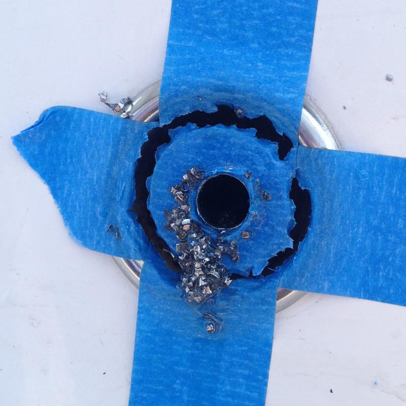

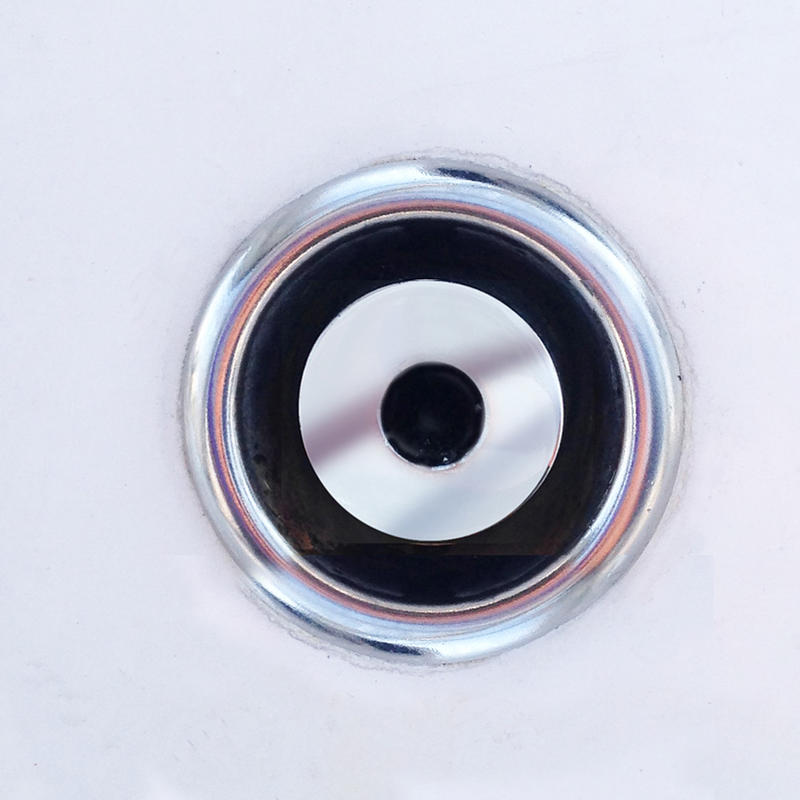

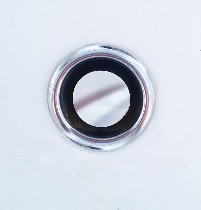

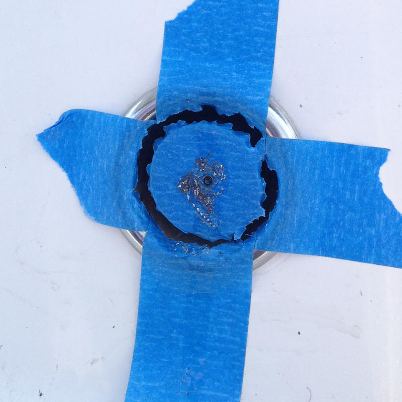

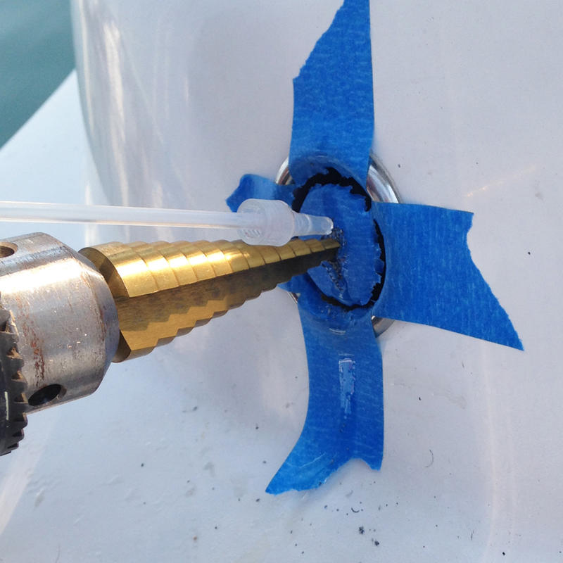

Hey Peggie and Ralph,
I've attached some photos of what I did (it's really nice living only 5 min. from the boat.)
1) Protected the chrome and used a center punch to start drilling.
2) Created a small pilot hole with a small drill bit
3) Used a step-down drill bit and lots of oil and drilled a 7/8" hole (I might make this bigger.)
4) Used a water hose to clear out the blockage and pumped out. Worked like a charm!
Thanks for all the suggestions!
