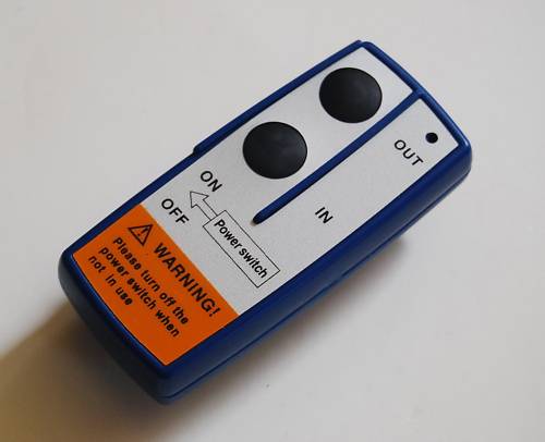

Yes, I found a remote that will do exactly the same functions, is waterproof, and absolutely compatable with most all of the windlass contactors. And it looks exactly like this:
And it costs ten bucks plus shipping.
What you will notice is a handy-dandy remote control, and a small black box.
Inside this black box is the RF receiver, and 2 relay output channels.
This box will wire up to the existing Lewmar windlass relay contactor, and instructions are enclosed with the unit.

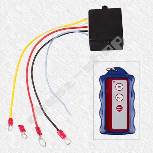

Sorry, wrong photo.. This one is correct
There is only one type of windlass this won't work with, and that would be the units that don't have an external contactor. 90% plus of the windlasses use an external contator relay which is controlled by the foot switches or hand held remote. The ones that don,t have a contactor have large guage wires running to the foot switches. These are very rare, and I haven't seen one in years.

This is the correct photo

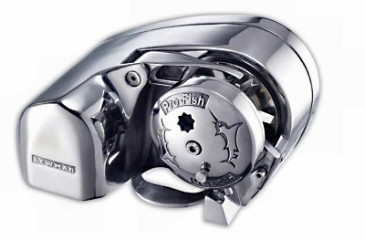

I just finished installing my new Lewmar windlass last week, and l love it. I haven't actually anchored out with it yet, but I've raised and lowered the anchor at the dock a few times to see how it works. It's pretty sweet to just sit there and watch everything happen. My lower back said thanks.

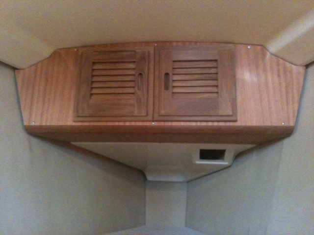

I installed a Lewmar 1000 horizontal windlass and mounted it on the starboard side of the deck so it would line up with the anchor roller. I decided on a horizontal windlass for two reasons: one is the shallowness of the anchor locker and the lack of any space to install a vertical windlass without doing major surgery; the other is I didn't want to intrude into the ceiling of the v-berth.
As it turned out, I had to intrude into the v-berth anyway, so I probably could have installed a vertical windlass for about the same amount of effort. Once I positioned the windlass in the perfect location on deck, I discovered that the hawse pipe opening was located directly over the aft wall of the anchor locker, so I needed to cut out a section of the wall. To route the anchor rode down into the locker, I epoxied in a 3" 45 degree plumbing elbow to act as the hawse pipe.
I also wanted to reinforce the deck with an additional piece of 1/2" plywood under the windlass.
All that required cutting a section out of the overhead in the v-berth. Then add in all the wiring and the contactor, and you've got a visually unattractive mess staring you in the face.
So I decided to just add a cabinet to the v-berth to hide all the ugliness. In the end, I probably could have installed a vertical windlass anyway as it would have been hidden by the cabinet. Now I've got a nice looking bit of additional storage, and a place to mount the new receiver for my nifty $10 wireless remote.

Really nice job. Thanks for the info. What is the vent looking piece under starboard side of cabinet? Remote storage?
Wally
Apr 6, 2007
120
Hunter Legend 37.5 Isla Saboga, Panama
Wally
Wally, Thanks. That vent looking piece is just the access to the end of the water tank fill hose where it connects to the bottom of the fitting up in the anchor locker. There a little square plate I haven't screwed back in place yet to cover it up.
It's amazing how much space there is between the fiberglass headliner and the actual hull at some spots. If Hunter had decided to fill all that space with structural foam the boat would be a lot cooler in the summer. And probably a good bit stronger.

Seller must of caught wind of this post. Now he wants $60 bucks for it.
