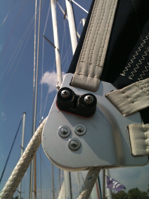

So, here is a really neato solution that will take about 1/2 hour to install, and cost $15. As well, you can adjust the leech line in 30 seconds, and let it off in 5 seconds... all without buying a pair of stilts.
So, here's how simple it all is.
To install this cleat, you need to CAREFULLY drill and tap a couple (depending on the cleat) of 8-32 threads in the aluminum outhaul clew bracket. Take your time and make sure to keep clear of the pulley. You might have to cut down the screws so that their ends are flush with the inside cheek face. You don't want the screws protruding through the back, as they can mess up the outhalll. Put a small bit of Blue (NOT RED) Loctite on the screws, and they will go nowhere.
Then put a large bowline loop on the end of your leech line. Big enough to easlly put you finger through, but more importantly, easy enough to catch with a very simple Hunter Model 1000 leech line snagger; otherwise known as a short lengh of coat hanger with a hook at the end.
You will love this system, it works perfecly, and allows you to adjust the leech tension effortlessly.
