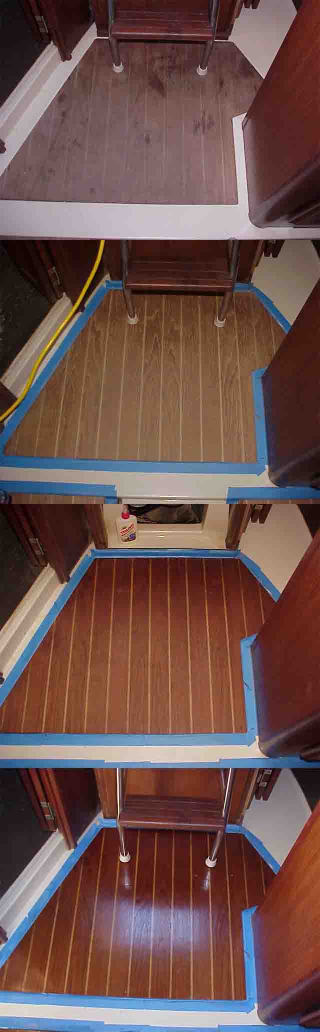

Refresed Cabin Sole Picture
Here is a picture of what a 1/4 quart of Profin, some sand paper and a bit of hard work can no for a tired sole.

Here is the picture that did not post the last time...

Photo explanation
Terrance: Your photos show a great progression of color and quality. What did you do besides add another application of Profin for the 2nd,3rd, 4th photo? Did you have to sand more than one time?

Michael...
There are a total of 5 coats of Profin down. The floor was in pretty bad shape, so I started with some aggressive sandpaper (60) and my palm sander. This may have been too much. 100 would have been better, but it got the job done and I did not go through the veneer. I then brushed on a coat of Profin and wiped it off after 10 min, as the directions instruct you. From there I let it dry and came back the next day and sanded it with a 180 grit sanding pad. I repeated this process for the next 3 coats. The final coat I did not wipe off. I have to tell you it looks 1000 times better than it did, as the photos show. In fact, it looks even better in person. It used to bother me how bad the sole looked. My interior otherwise is in great shape and I have had the cushions redone, so this just finishes it off. I was going to originally just replace the floor, but I had already bought the Profin early last year, so I figured I’d give it a shot to see how it worked. Because the floor looked so bad, I was not too concerned about damaging it in the process. Now I am glad I gave it a try, because it looks perfect and because it is not “brand new” it is in character with the rest of the interior. Which, by the way has Seafin on it and looks again 1000 times better than when I purchase the boat. Highly recommend giving this project a shot if you are considering.
