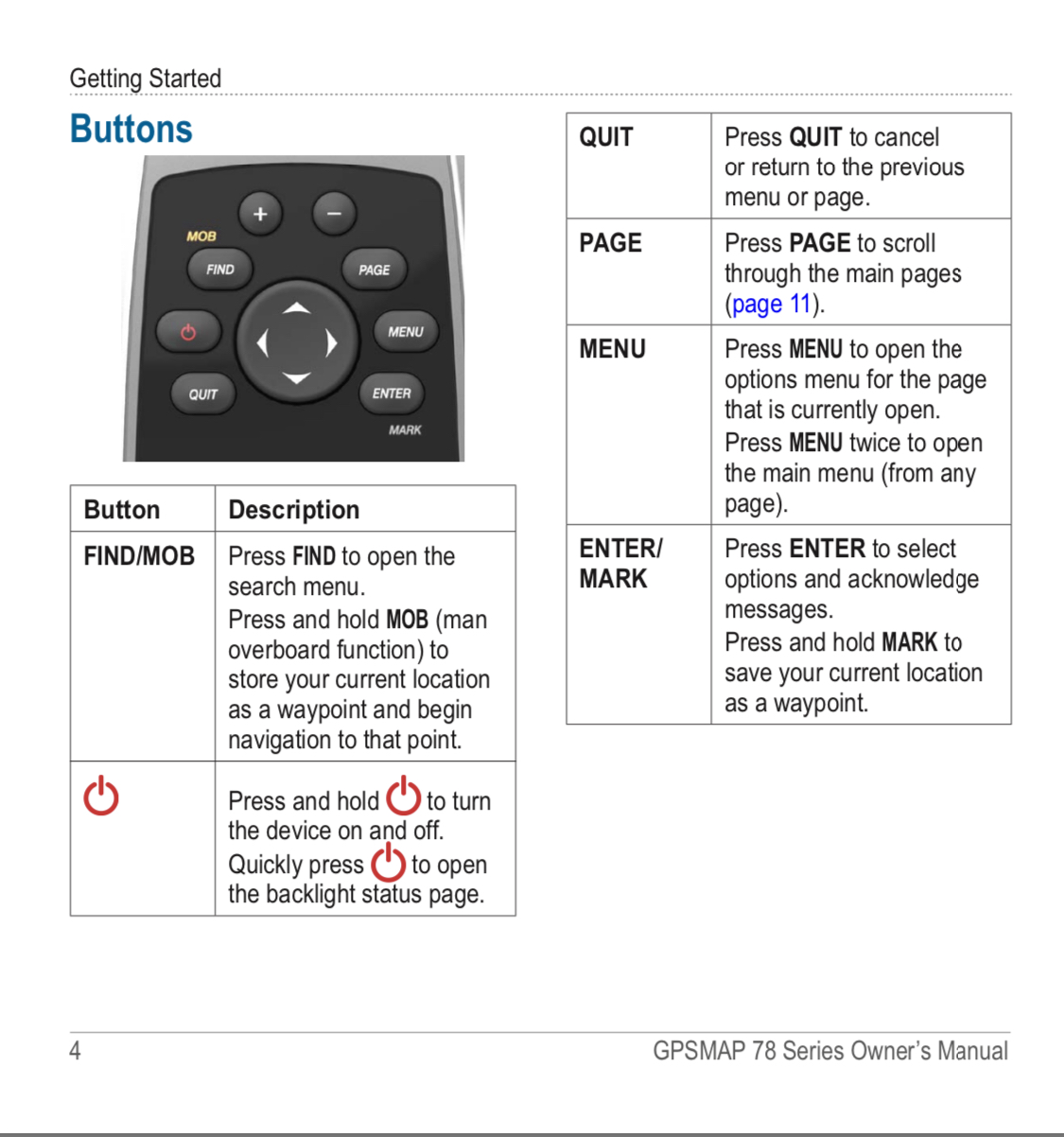

The West Marine kid directed me to a unit that looks like this:
It may not have some of the features but it also isn't $ 249. Is the enter button with
"Mark" under equivalent to MOB?
I'll poke around on the GPS Store site some.
Looks like it has a dedicated MOB button, the MARK button would also save a location so that’s the same but using it instead might be more complicated to navigate back to that point.

Jeez, I didn't even see that next to the "Find' button! Thanks!
No problem ;)
It nice that it floats! I would take your polarized sunglasses to the store and try it outside on a sunny day before purchase however. Likely better than the Iphone screen but worth checking out.
PS You could also try to use your phone in a different orientation, landscape vs portrait. The polarization of the sunglasses and phone screen sometimes conflict, rotating the phone helps.
