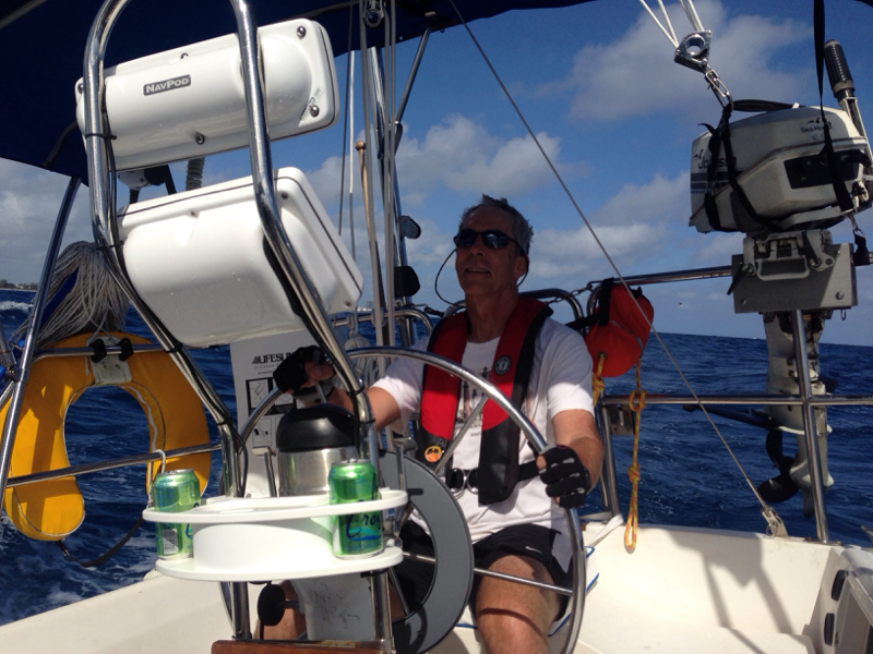

You must have great eyes. I have mine mounted at the helm.
